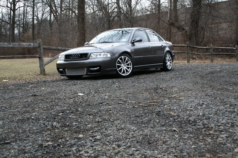

And here it is done.
With plate:
Without plate:
