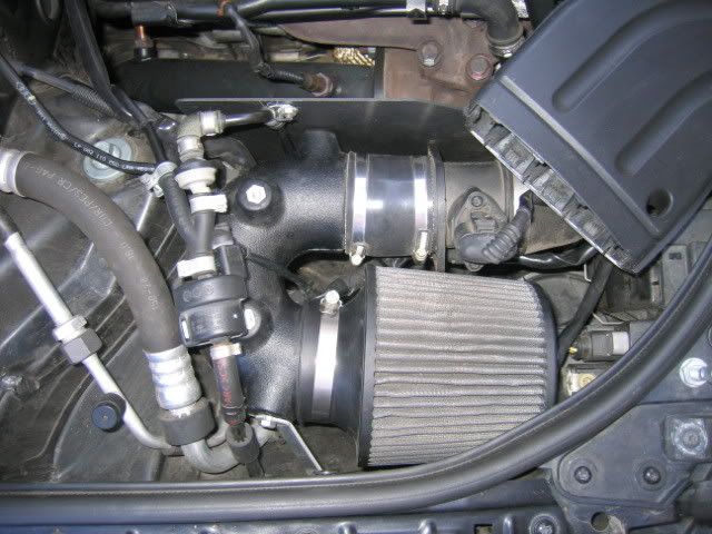

    you can see where i relocated the frequency valve..Since the maf will be down there I had to find a way to bring the wires there and cutting them wasn't a solution..Also i didn't like all those vacuum lines up there, I like it clean
    BetaAlphaTau member #19

    My biggest issue right now is the intake from the maf to the turbo...Not enough room behind the headlight if Someone has ideeas let them flow

    Run an elbow left off the turbo then down though the hole where the SAI pump used to be. How about a straight down pic with the headlight installed to give an idea of room.
  37. #157

    Quote Originally Posted by dirtybrd View Post
    I already thought about won't work unless I run with one light

    Re: engine build with pictures
    now this is another type of light from a normal model A4 It may work, it has to work, although not much room
