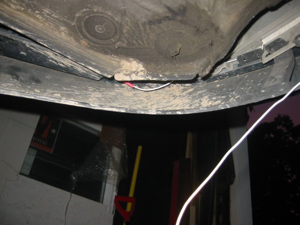

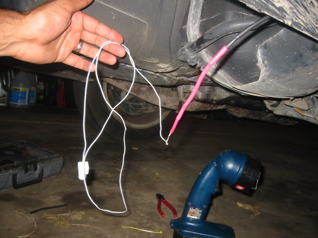

    Extend the keyless remote range dramatically for free
    This is on a 1999.5 A4 Avant 1.8t AEB
    Yup, tis true. It didn't cost anything and didn't take long. I followed the S4 keyless antenna thread and took pics of my own. The stereo on the piano gave up it's cheapie wire radio antenna for the benefit of fine automobile modification.
    Antenna reception was previously spotty at the end of my driveway which is only about 20 feet long. I could arm or disarm but couldn't maintain a solid enough signal to put the windows up. I had to be within 10 feet to work the windows. After adding the antenna I tried it across the street and it worked perfectly. I walked a house over and it still works. At the point it stopped working reliably it was about 75 feet away. It would do the windows from about 60 feet. Range will be best from the rear since that is where the antenna is. I'll play with front reception tomorrow at work.

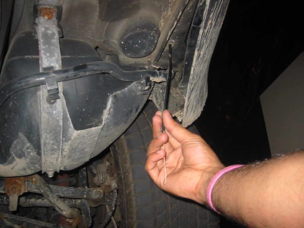

    The wire pulled down and about 4" stripped off the black striped cover.

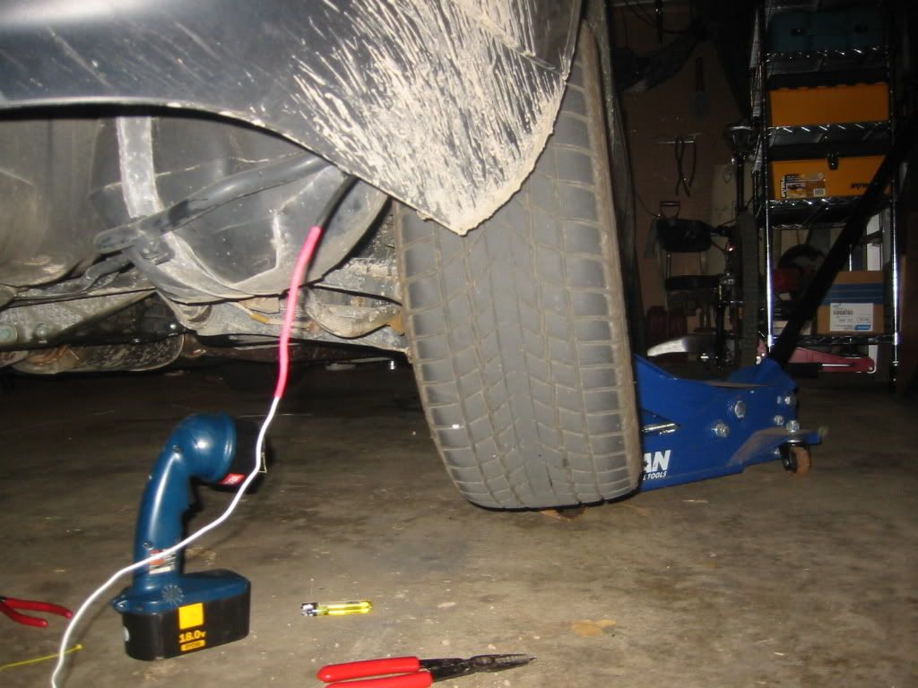

    Spliced the wires and heat shrink wrapped the joint.
    Location of the dangling wire.

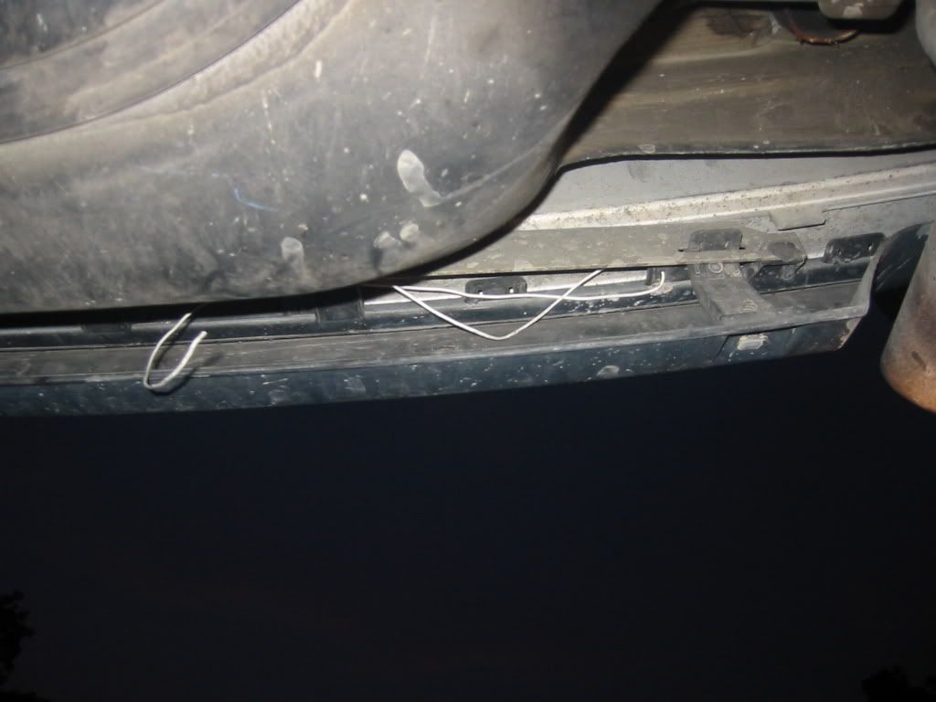

    The wire routing around to the rear bumper support.
    Here the wire is shown tucked up and around the rear bumper support. I looped it through the little openings in the bumper and zip tied the end in place.
