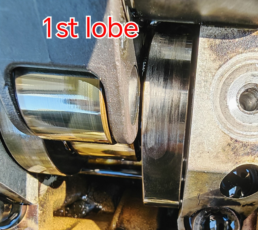

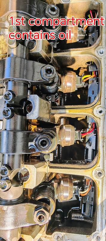

I am thinking hydraulic lifters and cam. But should that give so strong vibrations. I did remove valve cover and tried pushing lifter with screwdriver. There is a play of 1+ mm on depressed lifter. Checked only one.
Cam do not have any hard wear but there is a longitudinal discoloration on both side ends of some cams.
Any idea what could be the cause? I would like to avoid pulling engine out.
