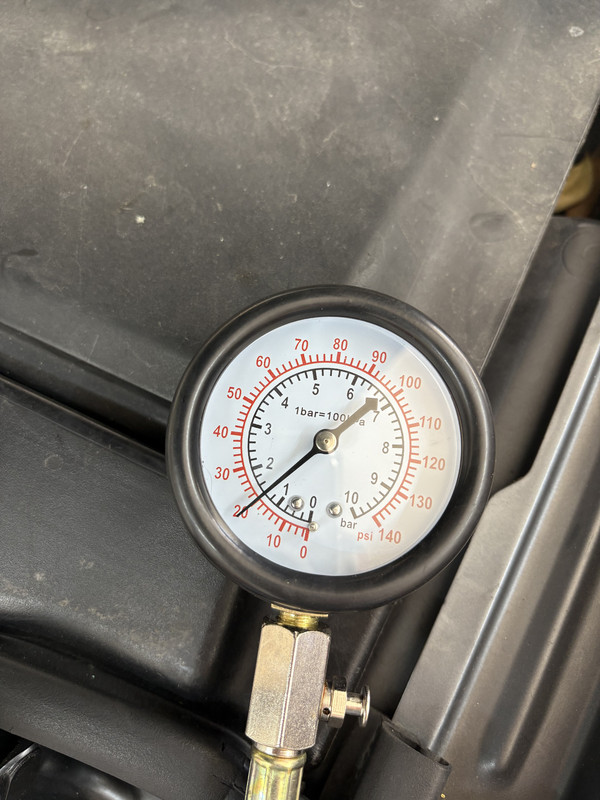

    I hooked up an oil pressure gauge and at idle it looks like things are within spec at 20PSI.
    I have also read through the huge 1.8T oil pressure survival guide as well as a few other posts on the subject:

    If my oil pressure dips down occasionally (below the normal range), what is the actual issue? The oil pump, oil pickup tube, etc. have been replaced. So, what else could be the root-cause issue here? Anything else to check here in terms of common issues?
    If I can provide any additional details from my end to assist in the troubleshooting process, please let me know. If anyone has any ideas / feedback / thoughts /etc. on what the possible root-cause of the issue is, it would be greatly appreciated!
