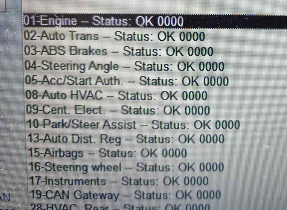

About 2.5 years ago and roughly 30,000 km back, I replaced the timing chains on my Audi and also swapped out the oil pump. Currently, there are no error codes from the engine, and the car is driven daily.

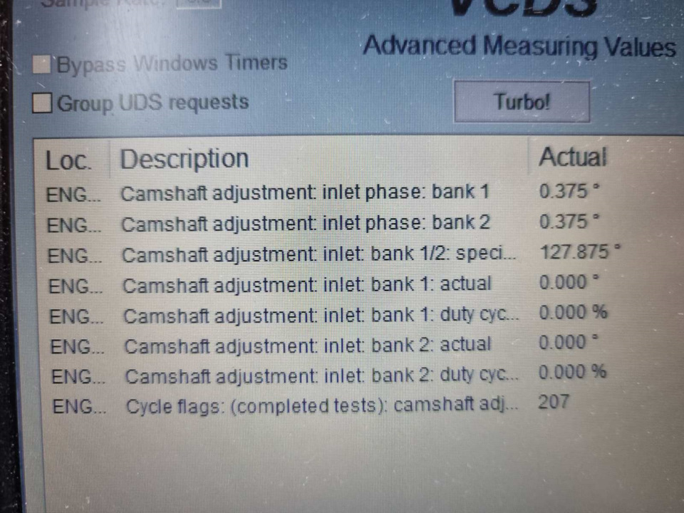

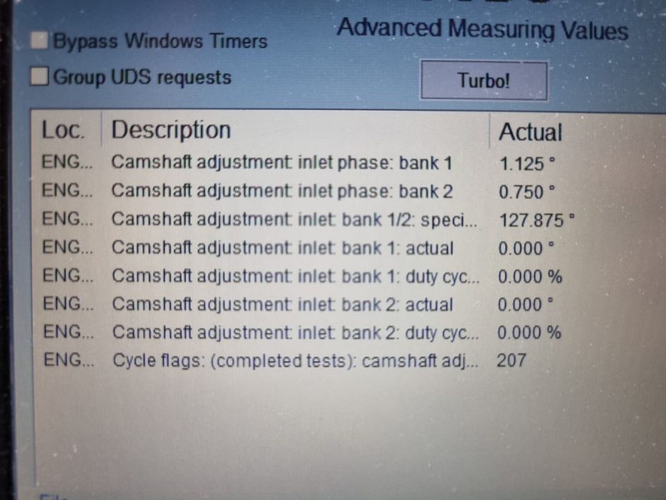

Diagnostics via VCDS:
I recently used VCDS to check the parameters for the chains and phasing. Here’s what I found
Parameters in Neutral (N) at 2000 and 3000 RPM:
Parameters in Neutral (N) at idle:

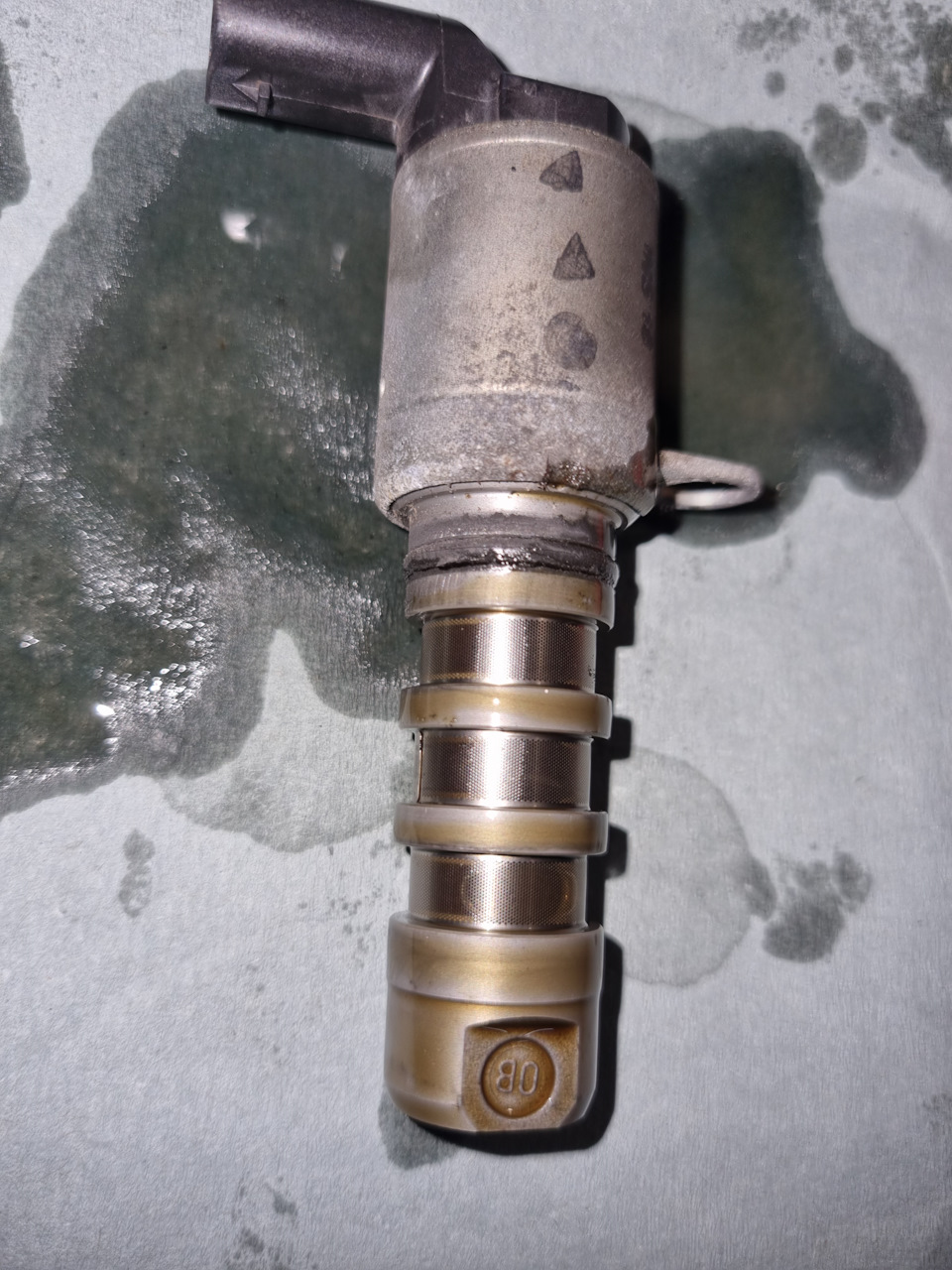

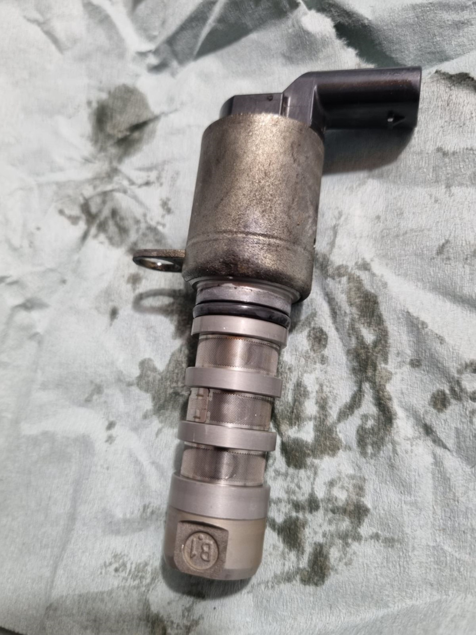

I cleaned the solenoids and replaced the seals with Elring 174.080.
Before cleaning:
After cleaning:
I rechecked the parameters via VCDS: https://limewire.com/d/8hD9G#sciXaMteGO
(VCDS log attached above)
Is there any problems in the log?
