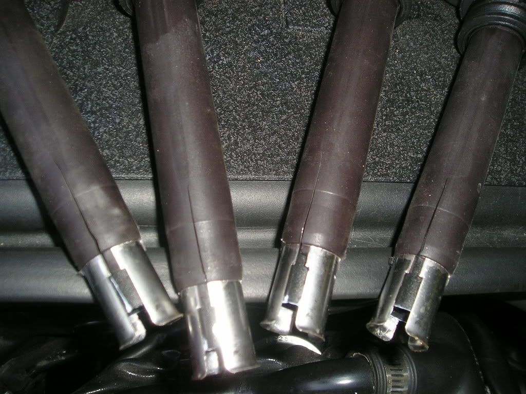

^ WTF, they all cracked with the adapters? I have a set of the red ones in my car right now, runs good, and I have a set of the black ones for the built engine arriving this Thursday, I'll swap them and see what happens.
yup, they all cracked inside of 3k.

Dam you and Dan must have gotten the same batch.
Any others ?
Just pulled my own and they're just fine. I've got about 500+ miles on them.
EDIT: Looks as if you forced them in. My own were a bit tough so I stopped and sprayed the coils jackets down with silicone spray; wiped off the excess then installed them. They went in easily.

I've got 3k on the clock on my coils and they are just fine. I also installed them into the adapters first to make sure I got a good seal between the adapter and CP.
lubed them up with silcone spray each time they went in.
if vw will swap these, im going to clamp a spark in my vice and hamer a coilpack down onto it and see if it splits the same.
im betting it wont.

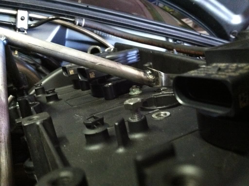

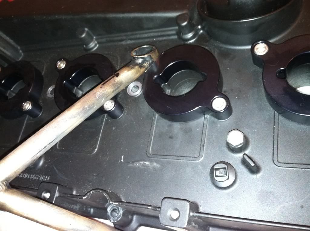

oh man.... If I went through the trouble of modifying my turbo brace and these adapters to work together and they fail continuously I'm going to be mad[facepalm][headbang]

Yeah, I lubed the coilpack seals with silicone spray, then installed the adapters on the coil packs, then inserted the coils with the adapters already located on the coilpack seals, into the plug wells until I felt the coil click onto the spark plug, then installed the screws, there is no down force on the coilpacks from the adapters, and the silicone spray lube helps the coilpack settle with the adapter without any downforce against the plug after installation. The coil pack must be able to float vertically as the coilpack heats up and expands length wise, and contract again as it cools down with the engine shut off after running. If the rubber seals are to dry in the adapters, then the heat up expansion will stress the coil pack in compression when hot, and as it cools, the stress from expansion lengthwise, decreases to nominal zero when cooled off. The thermal cycling if bound up in the seal will eventually crack the coilpack body. The same type of failure also seems evident from an unsupported coilpack as it vibrates sideways in the plug well, bending the coilpack body and causing the stress crack failures from that different failure mode.
