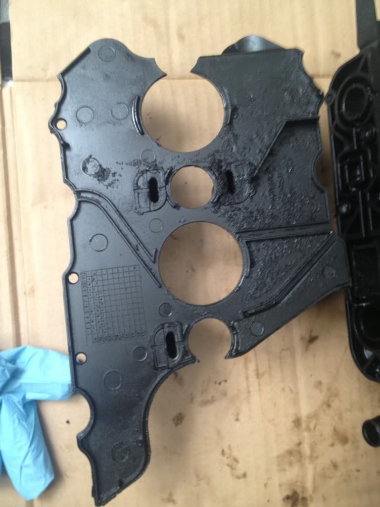

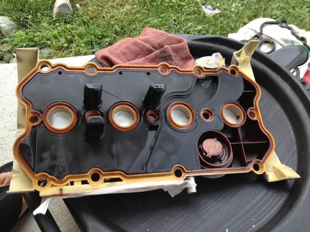

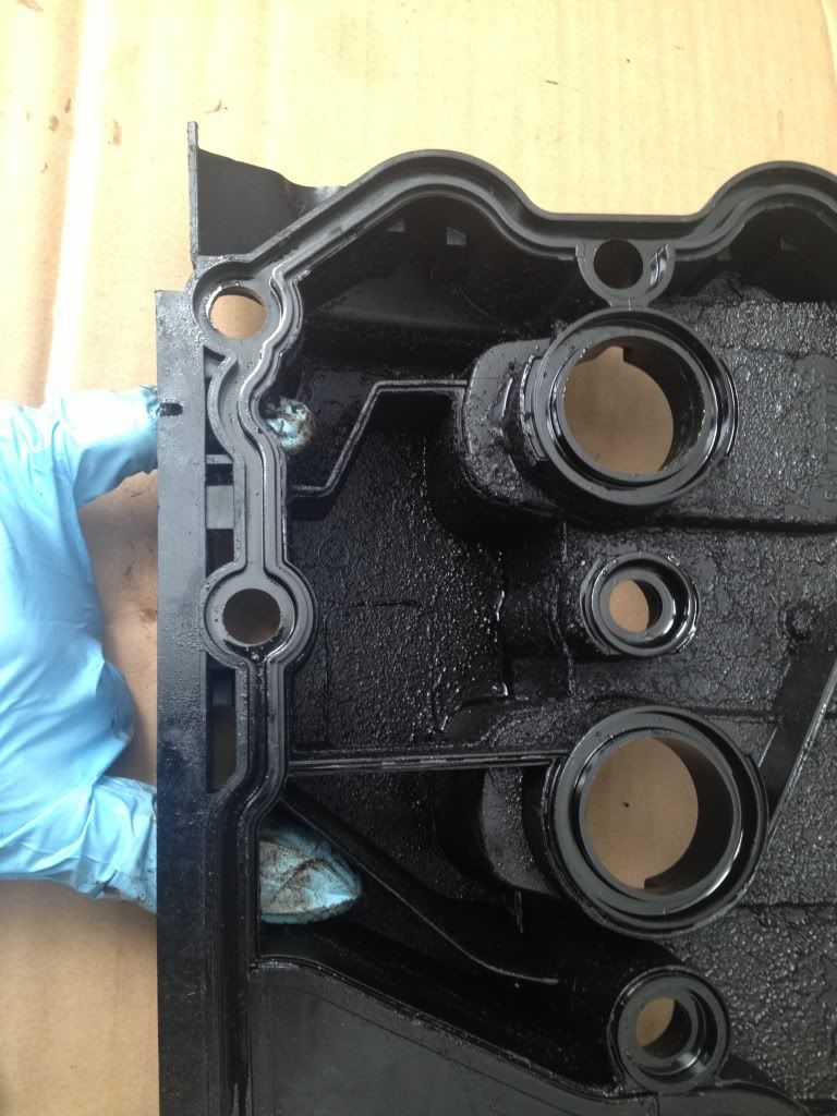

First of all many thanks to Steve(Sweir1171) who sent me his bad valve cover at his own expense after I started this thread http://www.audizine.com/forum/showth...earch-purposes

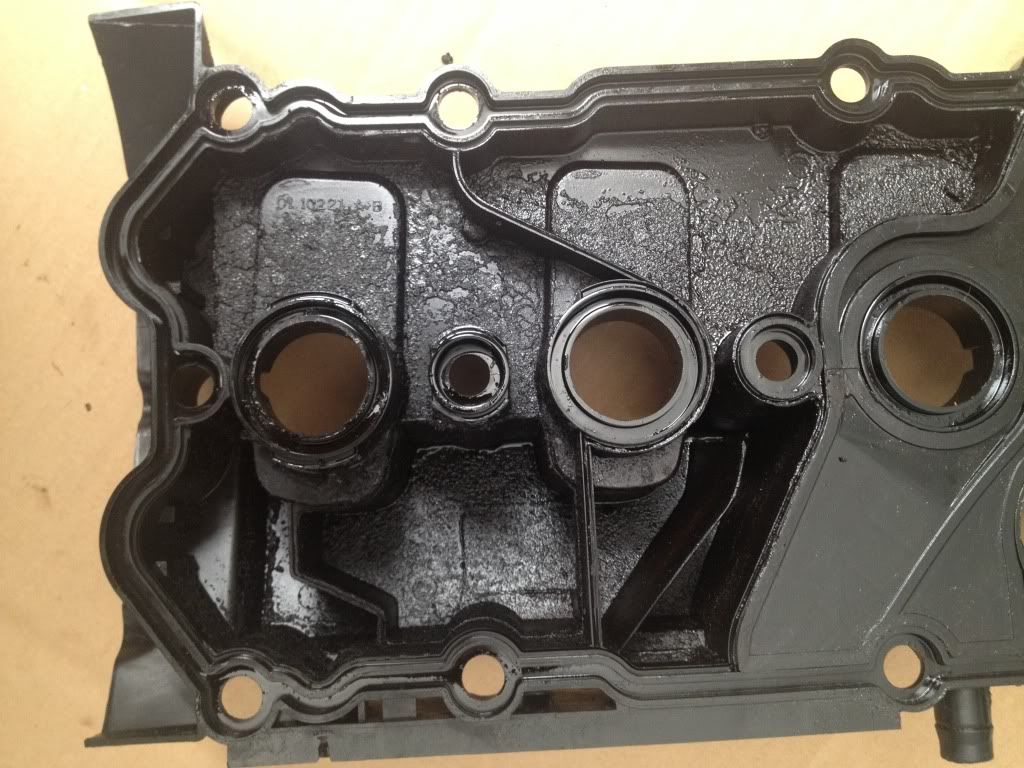

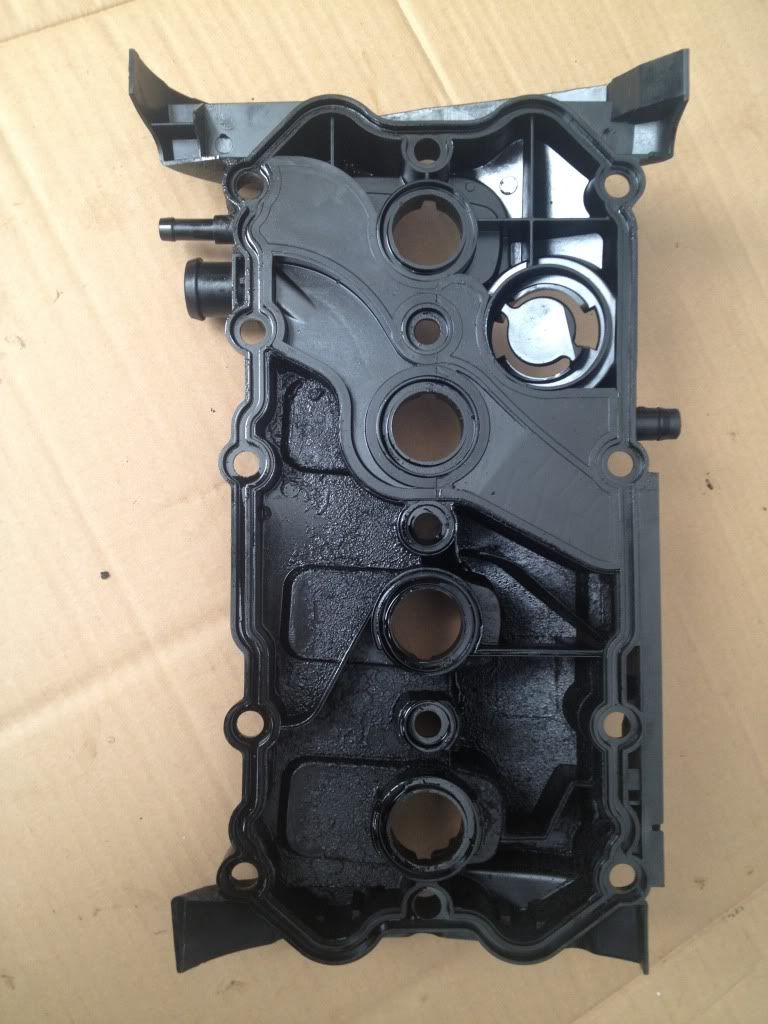

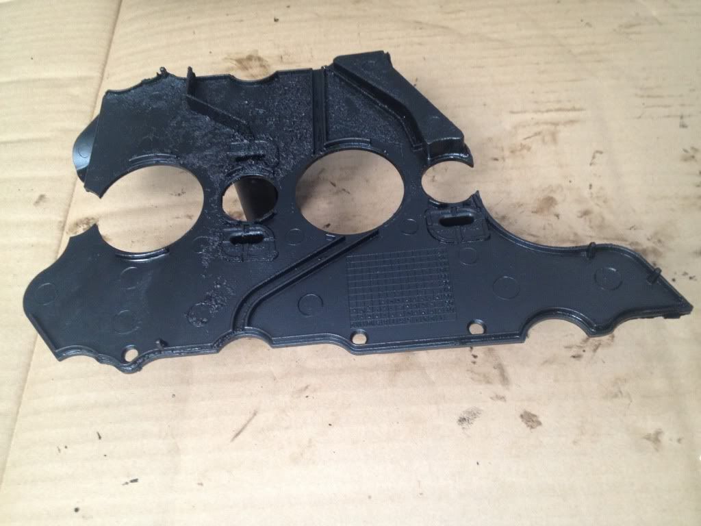

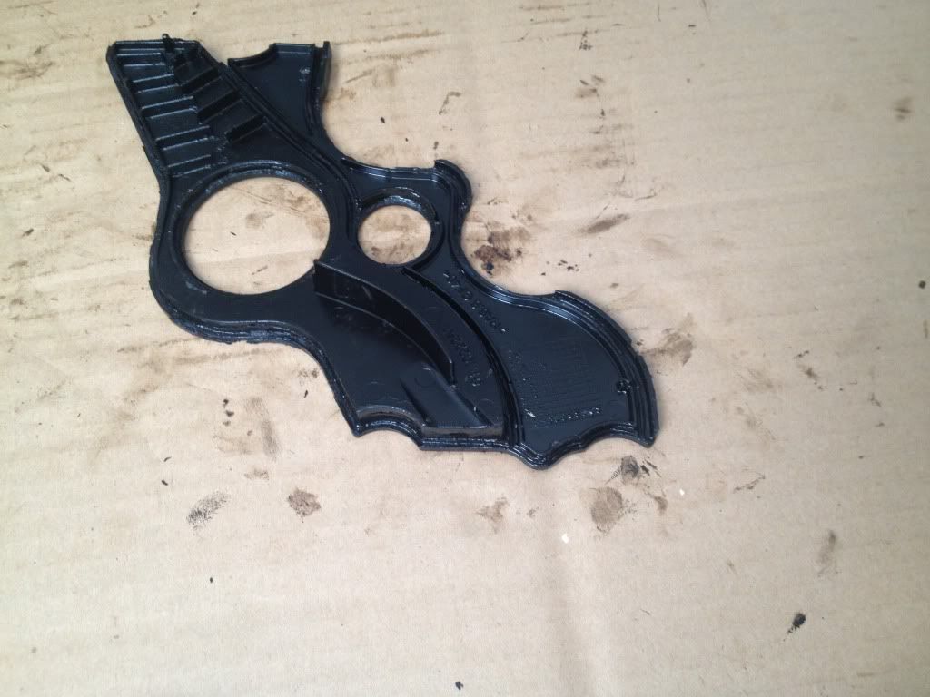

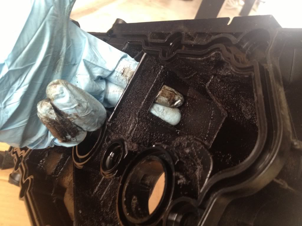

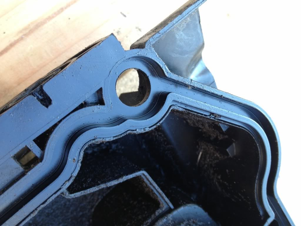

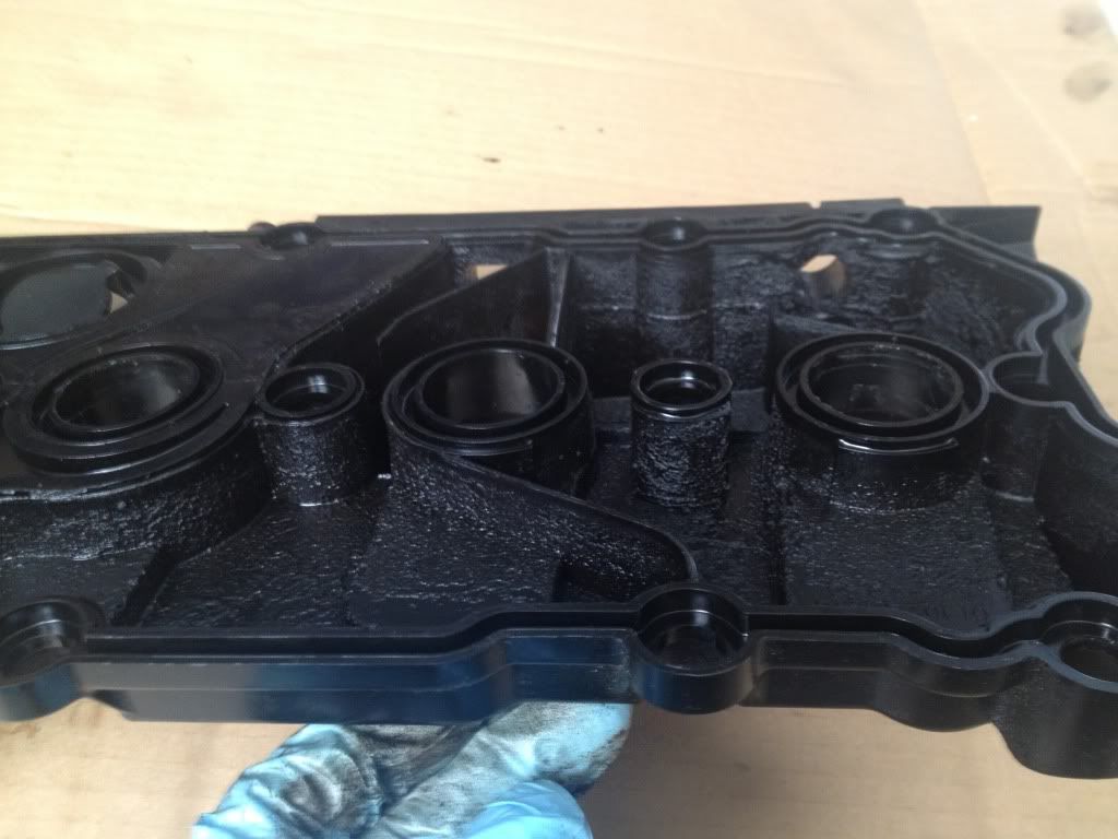

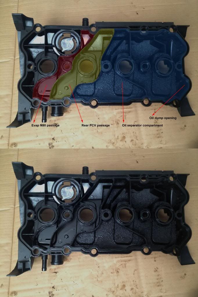

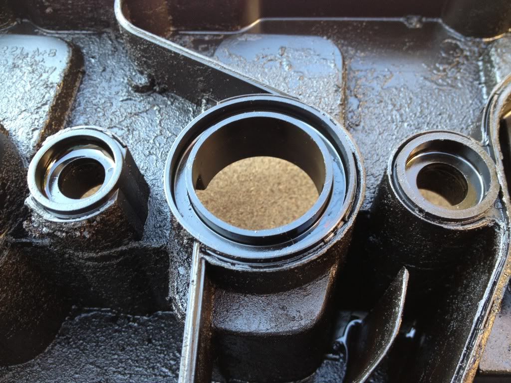

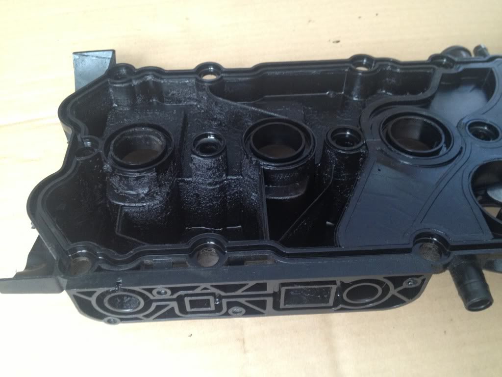

Here's a video I took while removing one plastic cover piece on the inside of the valve cover, the one that covers the actual oil separator that we have built into the VC. It was noticeable in some places these plastic covers became loose, pretty dumb design, they seem to be glued and apparently after a while the glue just fails. The engineers at vw/audi messed this one up too.
This is one of the reasons our engines burn a lot of oil, the plastic pieces on the inside become loose and make room for oil to be sucked right into the valve cover going either straight into the intake manifold or following the turbo path depending on the vacuum/boost condition of the engine at that time.

Some pictures too
http://i955.photobucket.com/albums/a...ps18777035.jpg
http://i955.photobucket.com/albums/a...psc4e55f2b.jpg
http://i955.photobucket.com/albums/a...psfbb59244.jpg
http://i955.photobucket.com/albums/a...ps6bb09aa0.jpg
http://i955.photobucket.com/albums/a...ps6ac81505.jpg
http://i955.photobucket.com/albums/a...ps1d2c9aea.jpg
http://i955.photobucket.com/albums/a...ps2f375838.jpg
http://i955.photobucket.com/albums/a...ps7d24719e.jpg
http://i955.photobucket.com/albums/a...pse0736cc5.jpg
http://i955.photobucket.com/albums/a...psa82d82d8.jpg
http://i955.photobucket.com/albums/a...pscb11938b.jpg

It's hard to tell for sure, but it looks like that large cover also covers part of the passage that goes to the TIP. I'm not positive though.
