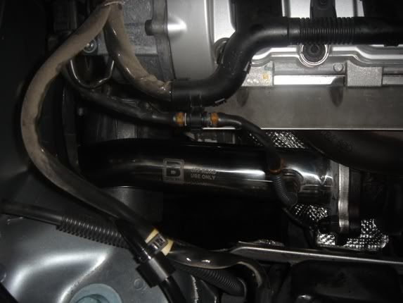

    1. Remove front oxygen sensor (O2)
    2. Remove the top 17mm nuts connecting the cat and the turbo

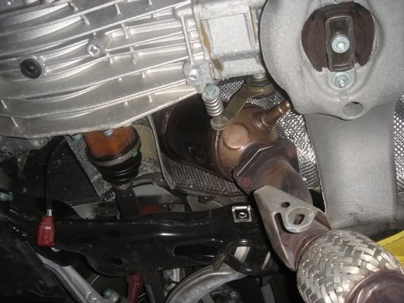

    6. Remove the spring loaded bolt holding the down pipe, don't worry the spring will not fly off when unbolting this

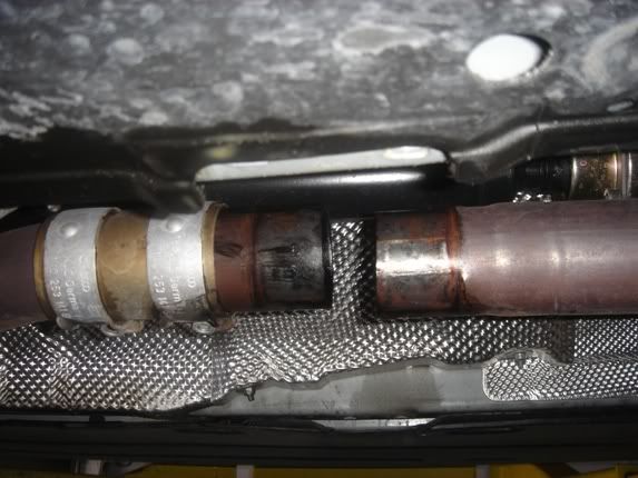

    7. Remove small cross member (10mm 12piont spline drive bolts) and loosen the exhaust collar nuts (13mm)
    8. Slide collar back toward the muffler

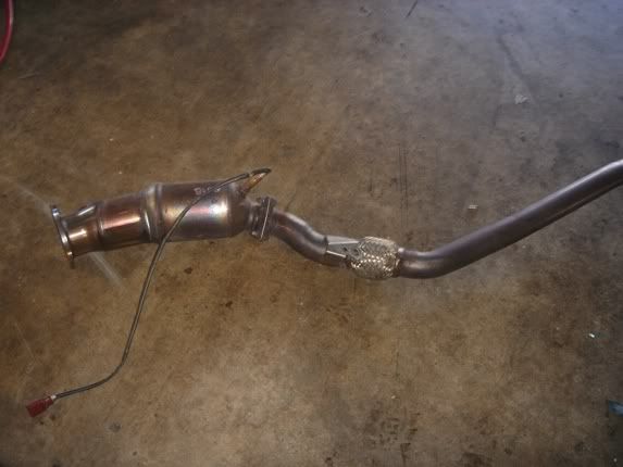

    10. Now unbolt the cat from the down-pipe (3, 12mm nuts on 3, 13mm bolts) and install testpipe to down-pipe, don't forget to replace the gasket, nuts and bolts
    11. and now just follow steps 9-1 to finish installation of testpipe. the finished product

    It depends if you can get the car high enough so that when you do step 9 the down pipe hangs pretty low you might need to unbolt it while its hanging like in the pic. and the bottom bolts (17mm) on the turbo side might be a little bit of a stretch if you have wide arms but still very doable. slide under the care from the front not from the side I think its easier that way, that way your facing toward the cat. when your unbolting everything
