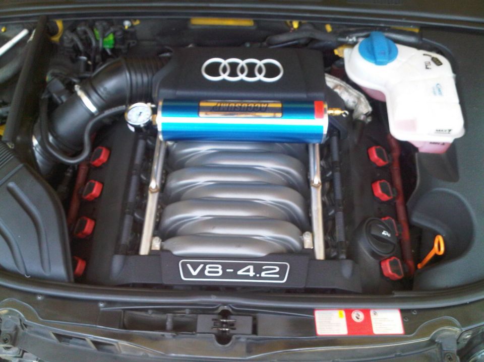

    well since all the interested people doing this mod are here an keeping it live , I did tackle some stuff in my car got the fitting were I am
    hooking my system, And is thru the were the oil pressure sender is, drill and tap the fitting so keeping the sender in the same position made a short AN6 flex line so the valve can be attached seperate from the accusump less space for the accumulator is needed.I did fit the accumulator on top of the Intake but it doesn't look nice , I still think it should be fit under the car ,battery well is to small,engine bay it tight,fender well is were I,m cheking this when i get some time ,if not behind front bumper .going slow on mine since work takes alot of time off.i got some crappy cell pictures i will try to post.

    Quote Originally Posted by Latosa View Post
    Pictures would be great!
    So, did the solution also work for you, or is it not active yet?

    posted some pics on my gallery , installation location for the tank is not permanent until i test this for couple weeks it will be behind the front bumper made a braket for it ,fitting is a custom made since I'm attaching were the oil sender is .will post more some time this week with the valve and wiring .this for testing only ones proves to work it will look better

    [IMG][/IMG] oil galley were accusump will feed thru.
  16. #136
    Active Member Two Rings Latosa's Avatar
    Jul 17 2011
    78361
    1986 scirroco 16v,1982 rabbit 16v turbo 543whp sold,s4 2004 6mt
    Aguadilla,P.R.
    [IMG][/IMG]fitting were valve is tapped
    [IMG][/IMG]were accusump will be located temporary hood closes with no problem
    [IMG][/IMG]oil sender with out adapter fitting using AN 6 for valve conection

    ^ Damn, is that the 2 QT. unit? That looks big when next to the engine. Behind the front bumper might be the best locaysh. So is that T fitting pieced together or a custom part?

    very important question. Does it work? No more rattle?
    I understand you moved the valve from the sump to the oilsensorfitting for space purposes, but it also looks very tight there!!
    How big is the sump you used? ISit 2 or 3 qt??
    Has a T-piece been fitted to put the sensor and oilsump on the block together??

    That looks the same as 1qt one I have sitting in my garage waiting on an install also.
    I was thinking of going into the system after the oil cooler maybe at the fitting but would love more detial on yours and maybe the OP if he is still chekcing.

    my unit is 1 qt ,the fitting is a custom made 45 angle AN6 to 1/2 npt out of stailess steel I drill and tap the side to 1/8 npt so the oil sender can be in the same location,the loction on top engine is temporary until it gets tested ,i have done a couple starts hot wiring it and yes no more rattle i,m working on the wiring hook up to the car .

  32. #152
    Jul 17 2011
    78361
    Aguadilla,P.R.
    So to bring this one back from the dead ,I have been running my accusump now for at least a month now and no more CHAIN RATTLE ON STARTS ,at the end I think is better for our V8 engines overall.
  33. #153

    [IMG][/IMG][IMG][/IMG] so at the end I relocted the accusump behind the lower grill ,did some mods to the ps oil cooler to make more space I put an after market one .ran lineto the fitting behind the engine were the oil sender is ,remember this fitting Is a custom made fitting an is tig welded but i,m running a # 6AN line I made all the bracket for holding unit ,fittings ,as for the wiring is simple ground and the other lead to a relay activated when the ignition is on ,building up 50psi while running and on start up got 50 psi to prime all chain tensioners and waallaaaa! no more rattle
    sorry for ther crappy pic but I did tackle this in 2 days did not have more time for more pics since is daily driver .

    [IMG][/IMG]

    Dude, nice work. It looks good. But sounds like a lot of little mods to get it to work.
