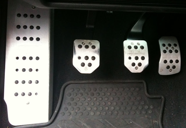

    I have the ECS version. I got them for better heal-toe positioning as well. I am quite happy with them.
    The OEM pedal height remains the same. My gas pedal is about 1-1/2" lower than the brake. Brake and clutch are the same height.
    I don't have a problem with the gas pedal being lower. I don't begin to heal & toe until after I have started braking. By that time the brake has moved to the same height as the gas.
    Some notes:
    • I offset the brake and gas pedal closer together by 1/8" each when installing.
    • The rubber nubs fall out. I've lost 3 or 4. Some people have had luck gluing them in first. I'd do that if I knew where to get more.
    • The ECS and AWE price is about the same. The ECS package includes a spring loaded automatic punch. Handy if you don't already have one.
    • You can see the scuff marks on both the brake and clutch pedals. I would take this into consideration if looking at anodized pedals.
    • The RS4 pedals don't appear to add any width to the existing OEM pedal.
    • Good dry traction. OK wet weather traction with rubber soles.
    They look better in person than they do in the iPhone pic below.
    good luck.

    mmmm good look and I like that they are wider, but do not like the rubber pieces falling out. thats a bummer...
