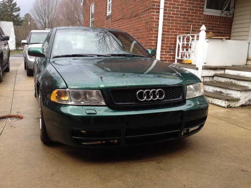

    This is what the car looked like when it was on the stock K03s

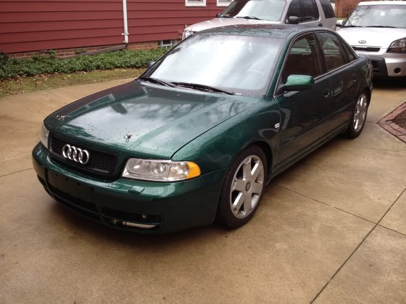

    And here is where it is now on jack stands

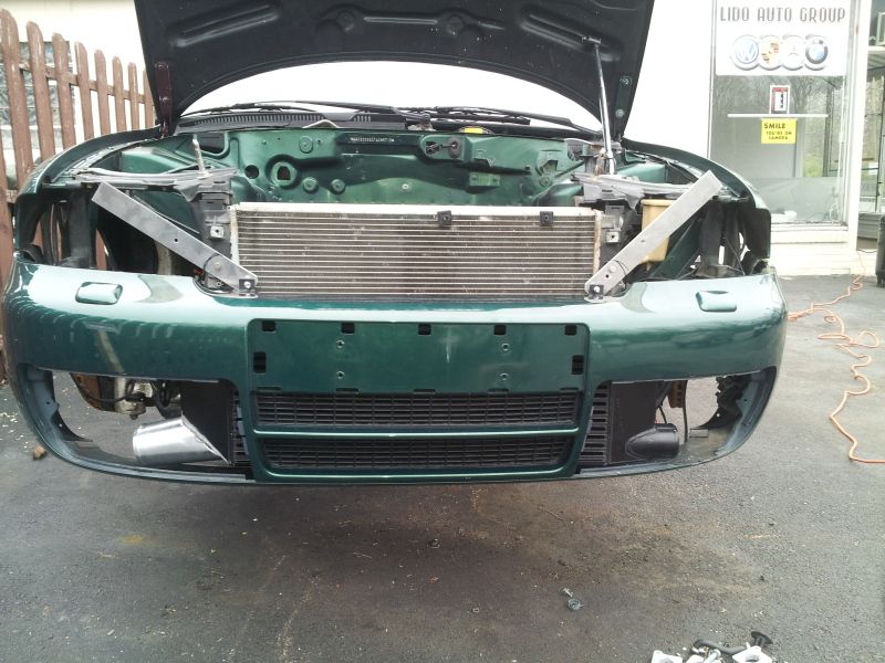

    Getting started on the fabrication!
    Nice , just buy Some rods man and boost this S4 :) any way you will take the head out , 29-32 psi this think will be crazy believe me .

    Lol we will see, I am really trying to keep this on a budget to see how the car will perform, how reliable it will, how drive-able and street friendly it is. If I like what I see, I will continue to a full build and maybe upgrade to a ball bearing 6765 for even more fun.
