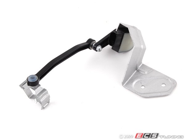

    Had this happen to me recently. Fixed it Sunday.
    On the left side of the car in the wheel well is where the sensor is located. It's an arm connected to a bracket that sets the headlight level based on the ride height of the car. Here is the picture from ECS:
    Here is a picture of the suspension and where it is installed:
    On mine, I hit a hard bump (railroad tracks) and the connector simply wiggled loose. I pulled it off, cleaned the junk out of both ends, plugged it together until the barbs would engage, and the self-leveling feature of the headlights worked properly again.
    It seems relatively straight forward. I appreciate the info/help.
