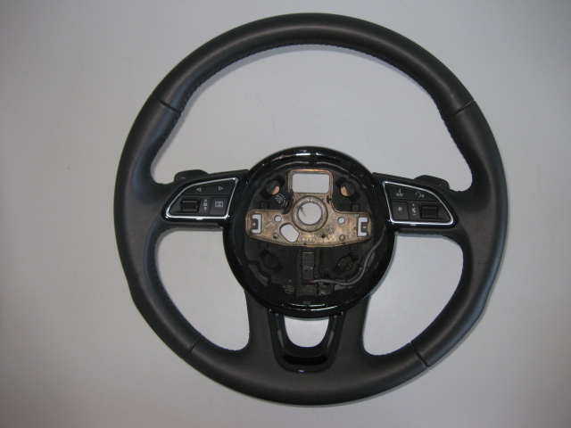

    Thanks. I ended up buying a 4 spoke wheel with mfc and paddles via ebay.de. My hope is that I can pick up a black airbag cover to replace the green cover on our current 4 spoke airbag. They're common on ebay for $50-70. If I can do that, the total cost will be ~$400. A far cry from $1,000-1,500 for a new 3 spoke. Would have preferred a lightly used 3 spoke sline wheel, but was not keen on shelling out for new airbag.
    Biggest learning experience for me thus far is that the Q5, A3, A5 sportback and cabriolet share wheels and airbags. Also, the airbags and wheels with these models have two spikes vs other combos such as those formthe A4 B8. I will post pics after I receive and install it. Fingers crossed that mfc buttons will work properly and that the paddles will work after applying well documented vag com settings.
    Generally, it appears that steering wheels are compatible across:
    Audi Q5 8R
    Audi A5 Cabrio
    Audi A5 Sportback
    Audi A3 8P 2008-2012
    The 4-spoke wheel I bought is: 8P0 419 091 ES 1KT

    I know that many parts same but have different serial numbers
    Electronic parts catalog for Audi shows that number 8P0 419 091 ES 1KT for Audi A3
