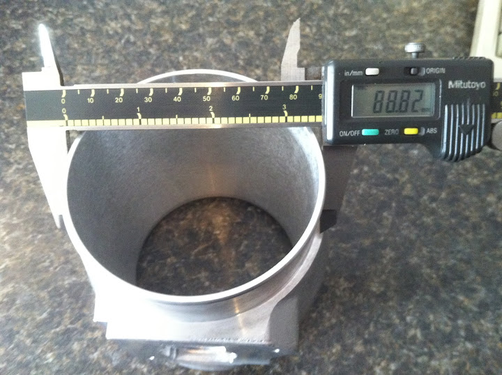

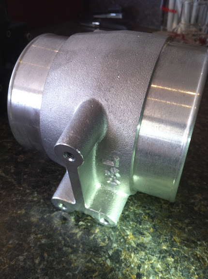

    Just got mine, looks like a steal for $45.
    Looks like rs4 accordion will fit well. Might need to cinch the clamp a little bit, asp housing is 91.8mm
    Intlet will take some work to go into the airbox. Maybe a trip to vatozone to ghetto fab a cai.
    ID is straight through and nicely finished.
    This is going to get the sawzall and grinder.
    Looks a nice piece for cheap ass mofos like me collecting stg3 parts for the day the turbo lady comes a knockin. Hopefully dude can get some more or whoever horked them all up doesnt put some hellacious markup on them.

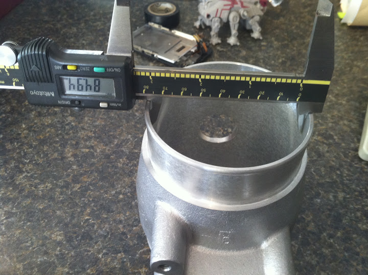

    Oh ya, heres the overall compared to asp. Feels just a hair heavier also. Even came with a tamper proof torx bit for the screws.

    looks like a couple options for the airbox, the first is a straight 4"-4" on the outside of airbox would work if you shaved off the the clamps,(i have a second airbox lid coming my way for that or a 3.5" tube into the airbox. I'm curious as to how this will work out.

    Was hoping I could turn it down but being 85mm all the way through makes that tough. The asp is slightly tapered to fit into the box. Awe has an even more drastic taper.

    i measuered the outside diameter of the stock airbox on sunday, where the maf clamps on it 4" exactly outer diameter, with a bunch of crap on the inside that the oem maf plugs into, but once you clean up all the excess I would imagine that a simple coupler from maf to outside of airbox would me most effective option, keeping factory filter, and box. other options are 4" hole with cone filter inside box(acting as a heat shield) or a straight 4" hot air intake. maybe a cheap home depot heat shield, but then you loose the ICM heat sink.

    I modified the stock airbox top so i could modify it to fit the larger housing.
    first things first the outside diameter of the airbox outlet is 4" so a very simple 4' coupler will make a good seal to the MAF inlet after you remove the clamps on the side of airbox, very easy with a hacksaw.
    then I looked at the transition from airbox to maf. not very smooth and I could open it up a bit, so I got out the dremel and went to town, removing some of the extra material around the outlet. I went through the box and used JB weld to make new walls, sand it smooth and quick spray of black primer on the jb weld and maf housing.
