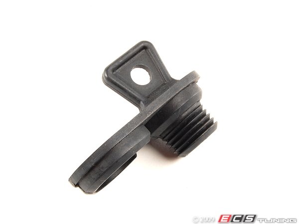

    I did some looking and I found an [8 dollar] plug that is used on the old (and I mean old) 016 transmissions. These were the original "quattro" transmissions before they started using Torsen center diffs. The 016 would be found on such cars as the "Ur Quattro" and 4kq. The same transmission design was also used on FWD models like the VW Fox, Quantum, Audi 4000, 5000 etc. Those would be the 012/013/014 manual transmissions. So this plug was in use from like 1973 (maybe earlier?) through 1988 or so, on every Audi/VW longitudinal manual trans car. (Quick disclaimer: I'm not a vintage Audi transmission application expert by any means, so if these facts are grossly over simplified or just plain wrong, someone please correct me)
    They used a rubber plug to cover a hole in the side of the transmission case. I cannot confirm the size of the hole, but it looks of quite similar size to the empty crank sensor hole that all us 4-banger guys have on our transmissions.
    CLOSE OUT PLUG: 084-301-115

    This plug is way too long for our tranny plus the existing hoel is not threaded
    Ours looks more like a blanking plate hold in place with a screw
    Phil
    I don't think it is too long. Here is the crank sensor that would otherwise go there:
    http://www.ecstuning.com/Audi-B6_A4-...ical/ES252763/
    And the plug is not "threaded". Those are just ribs for grip to hold it in the hole. In any case, it is just the diameter that matters. It is rubber, so if it is a little bit too long you just trim it with some kitchen scissors. You will notice the design of the plug itself (and indeed the part number) are similar to the VW transverse timing inspection plug:
    http://www.ecstuning.com/ES271376/
    Thanks for crapping all over my idea, Phil. (j/k, )
    I agree. A little tin plate with a hole and bolt would be the simple fix here. I was just showing how the factory did it years ago. And if that plug works well, it would be a really quick install as well.

    It almost looks like you could use an SAI blockoff plaste on that hole. Probably the wrong size though.
    Walky that "plug" looks promising. But who knows if it will work. At $8 its not a huge investment though.

    Any one have a part number? If so plug it into our site it should come up with a price.
    Jason
    I'll try to get it tomorrow. I had to spend the afternoon at the PA auto show disconnecting batteries on every car for our 7 stores today
