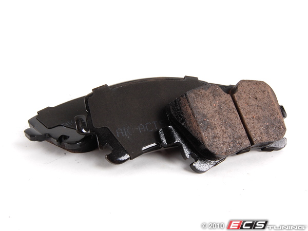

    My (too small) EUR1348 pads = 105 mm x 56 mm
    But I found these for the B8 A4 that appear correct:
    http://andrew-racing.com/i-7106132-d...b642z-658.html
    Note the size:
    Hawk Performance HB642Z.658 = 117 mm x 59 mm
    That was about the width that I was missing... So, I need to find the Akebono pads in that size.

    I couldn't find any Akebono pads in that size, so I ordered the Hawk Performance Ceramics HB642Z.658 from Tire Rack — I will install on Wednesday evening.

    Akebono Ceramic rear pads are available below.
    Click HERE to order or for more information.
