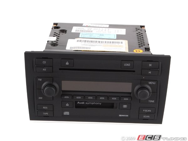

    My current headunit:
    Dumber question: If I just by the SAT version of the above headunit with the DICE version of the ipod interface, I should have no problems...right?

    I feel your pain. I have a 03 as well have have been dying to find a way to do this. I'll be following this one. I believe that you will need to get the new headunit as well. They had the unit for $39 but it still doesnt have the SAT option either. I would look into the Symphony II+ or Concert III. You get the newer headunit look plus your SAT option. Just need to make sure you get the AM/FM radio anntena working correctly.

    You need either the '04 Symphony II HU with the SAT button, or, better the Symphony II+ HU from a B7. Then, using a OEM SAT receiver box, and a custom wiring harness, mount the SAT receiver forward of the glove box or inside the glove box in the upper left compartment. You can use a Sirius/XM mini antenna mounted on the roof, with the cable run to the SAT receiver box. This is the setup I am using. It works perfect and operates and looks stock.
