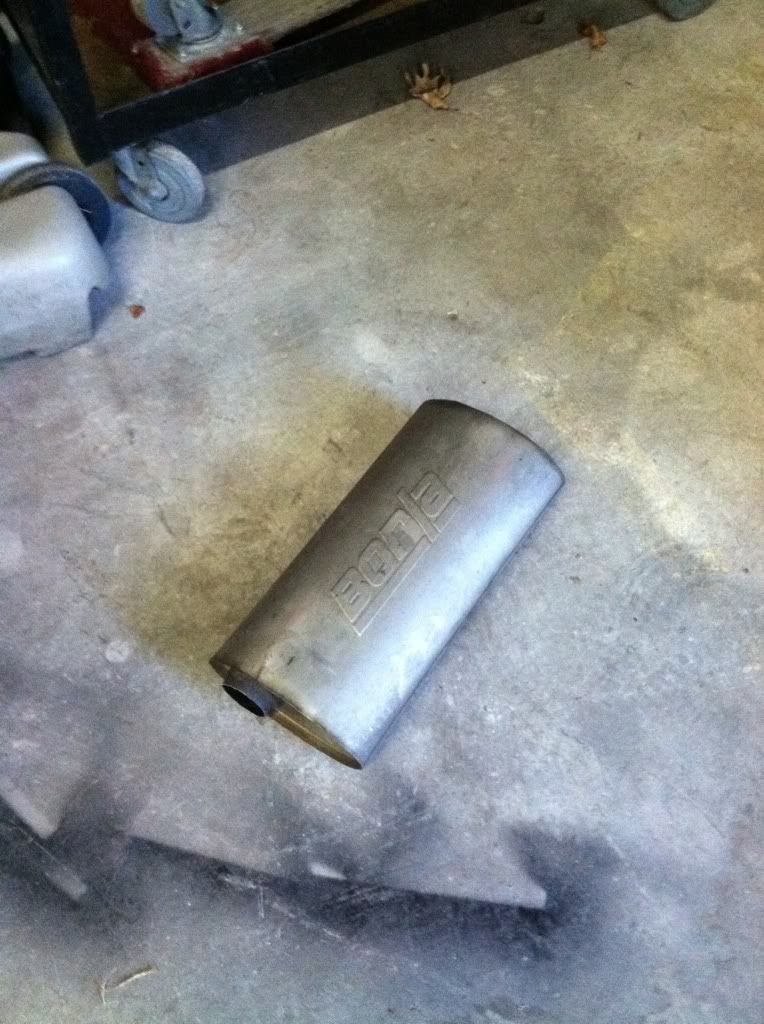

had my resonator removed to open up my exhaust a little cause it was way to quiet.

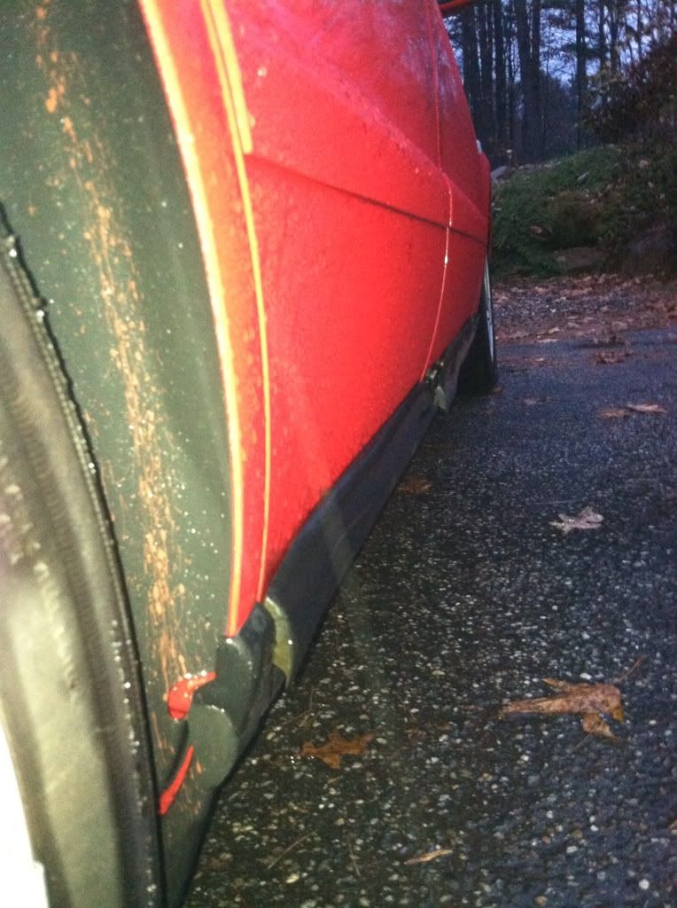

finally got my lower door moldings in from ecs and installed heres some before and afters
before
after

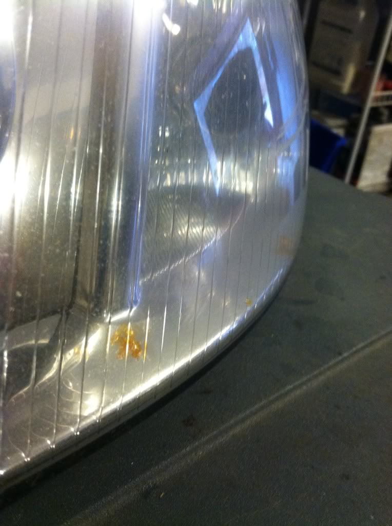

took the headlights out to remove all the residue from my old amber corner bulbs that was caught in the headlights
i know it doesnt seem like a big deal but it drove me nuts

Looks really nice man. How did you go about getting those amber flakes out of the housing? I have the same problem and it's driving me nuts.
my guess would be compressed air

lazer viking is right, take all the bulbs out and shoot some compressed air in there it comes right out

 Originally Posted by redmond1501
How does the heat gun trick work? Are you melting the plastic a little?
im not sure if it melts it a little or it just brings the oils pack out to the surface because he surface does not look different (like it would if you melted it) it looks stock
 Originally Posted by Justin@FCP
x2 on that! I remember you telling me about it on Vortex, but I'm impressed how it came out. What process did you use to bring the front lip back to life? Also how is it holding up since you did it? I'm tempted to try it on both my Passat and A4...and even my neighbor's Pontiac Aztek!
Just hold the gun up to the fron valence and let it go to work, be careful not to let the gun touch the lip or it melts it immediately. Its held up alright there are a couple spots i need to go over but it looks 100x better than it used to. I put back to black over it after i was done to help preserve it
