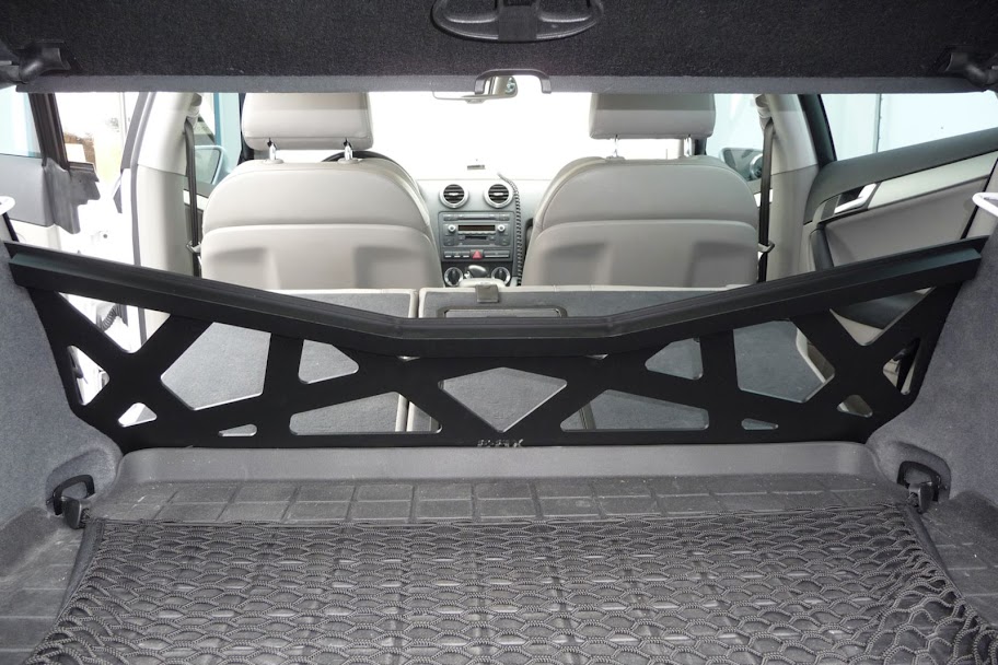

    I installed the recently released Unibrace XB designed for the A3. It looks clean and feels good. Reduces (but does not eliminate) open sky creaks when in closed position. Back end feels solid. Removes pretty easily with 5mm hex wrench (I keep one in the trunk). For me, it was worth the time and $. On to the pics:

    Wow, quite nice. Do they make one for the A4 Avant?

    I'd be willing to lend my B8 S4 as a beta tester for that piece of kit... Looks solid.

    That looks like a very good amp rack for mounting car audio amplifiers and zip tying all your power and signal wires to. I'm pretty interested in the product and it can serve as dual purposes and I can probably mount and show of all my audio gear there. Does anyone how thick (mils) the brace is in case I need to drill holes in there to mount amplifiers? looks like maybe it's a quarter inch possibly.

    = 1/4" or very close. I don't have a caliper here at home to check.

    JRutter,
    Did you have to drill holes into the body for mounting?

    Yes - Cliff notes: remove back seat, loosen/remove trim as needed, pull back carpet liner to expose chassis, mark & center punch, drill pilot holes, enlarge holes to 1/2", install nut serts using tool (much easier than DIY tool), put carpet back and drill holes in carpet for screws, put seat back in, install brace, buy hex wrench for trunk for removal on the go. PM me if you want to see the MK4/MK5 instructions in PDF.
