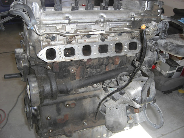

    I wanted to do this project differently than ones from the past. My old Talon took years to come to the final result. That was a combination of being very expensive and spending many many years in Iraq. For this project, I wanted to accumulate the overall majority of the parts for it and then start. As of now I have been buying parts for over a year.
    I picked up a used 24v VR6 last summer, a buddy and I went up to Denver and pulled it out of a Jetta. When I finally got around to pulling the cylinder head off a few months later, I found out that the block was cracked in the main oil return from the inside out. Bummer.
    Here is the old VR6.
    So I started looking at picking up another VR6. They are in short supply and I could only find a couple of 24V blocks in the US. They were priced really high and the shipping was ridiculous on top of that. I had already that a full B6 01E drive line to swap to manual, a 6765 and an FX850.
    So, I did the next logical think in my eyes. I picked up a APB V6 from and a 01/01.5 S4.
    I started looking at prices for twin "discos" and started talking to Guru about single turbo and Markuu about manifolds for both applications. Either setup would have been nice and I could have just got some ebay manifolds and threw a set "Franks" on them. That is just not me and the custom manifold prices are quite spendy. I figured with the amount of money needed for a custom manifolds and downpipes, twins and everything else, it would still be cheaper to pick up another VR6, rods, pistons and finish everything.
    I highly recommend putting everything into a spreadsheet, it makes life so much easier.
    Fortunately for me, In my opinion, I scored a sweetheart deal on a brand new 0 mile 24V VR6 from Issam. Thanks Issam.
    I picked up a set of JE pistons and Tuscan rods.
    After I received them, I decided to not use the rods and pistons on a brand new block just yet. I called Chris@C2 and talked over my plan with him. I decided to pick up a headspacer to start with and use the rods/pistons later when the tuning is sorted out.
    Head off:
    Head stud install:
    Head gasket and head spacer on:
    Flywheel:
    Installed:
    Twindisk:
    Installed:
    Starter, Oil filter housing, crackpipe, water pump and pulleys installed:

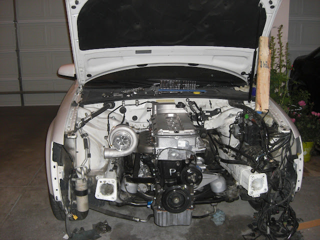

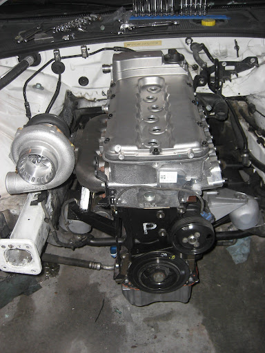

    Motor off the stand and getting ready to go in.
    Lining up 01E.
    Putting on Porsche 01E metal slave cylinder.
    USP slave line.
    All together.
    Motor, manual tranny, driveshaft, axles and read end swapped in. Now I need to make the passenger motor mount.
    A little something to make things easier.
    Motor mount done today.
    Completely in without assistance.
    T4 manifold, Billet 6765 installed.
    From here on, its pretty much going to be a little here and there. I am not sure how much I will be able to work on it for the next two weeks because of school.
