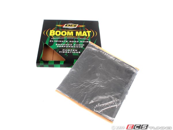

    May want to look in to using a sound deadening material.
    Ive used DEI's boom mat behind and around the interior speakers and it helps with little annoying vibrations and rattles.
    We have it available below.
    Click HERE to order or for more information.
    Let me know if you have any questions

    This stuff (boom mat) works great along with other brands like dynomat but this stuff is exactly the same at a lessor price...go ecstuning
