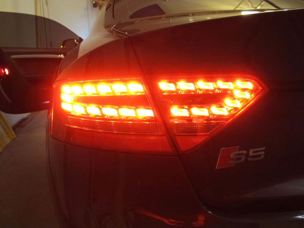

    Thanks to DavidB8, both Zee007 and I now make two (2) 2010 S5 owners with working rear fog lights on our cars. As you know, it did not come this way from the factory and so I had to order the H/L Switch (Euro part 8K0 941 531 AL WEP) from Alex with Europrice and then rely on David to be available to program the rear fog lights. It was fairly quick and it came out quite nicely. I was also able to see what it would be like to use the inner LEDs as fog lights but I didn't quite like that look. The first photo is the rear fog activated, the second photo is with the turn signals/hazards, and the third photo is just the running lights. Take note that by using the Inner outside assembly light as a fog light, it does not illuminate at any other time. Thanks again to David, Alex, and Auditech91320 (who helped install the switch) for making this possible and activating what should have come on the car originally.

    It's quite frustrating knowing that most of the other Audi models have rear fog lights. I don't know why Audi took that away from this particular model. As you can see, all it took was a switch and some coding. It would not have added much to the car at all if it came from the factory like this. Grrr.
    Since the NA A5 & S5's don't have the Euro H/L switches, here are a few pics of the H/L switch with the rear fog light activated. This project was especially nice to finish because of the "doubt that it would work" statement from the Audi parts department that I usually see. I'm not one to say, "I told you so" but.....
    For anyone looking to add rear fog lights to your A5 or S5, it's quite simple.
    1. Euro H/L switch (8K0 941 531 AL WEP) from Alex @ Europrice
    2. Remote coding help from DavidB8 on the Audizine forums.

    Aren't the fog lights supposed to be the inner section of the portion of the taillights that are mounted in the trunk lid? You are showing the fog light as the inner portion of the light that already illuminates while braking or using turn signals/flashers in stock form.

    These aren't Euro lights. You can't make a light appear where there isn't one. If you want to retro a bulb or buy the Euro lights then sure it can be on the inside. Personally I think it worked out pretty good.

    Quote Originally Posted by DavidB8 View Post
    So losing illumination in all other functions such as braking, signaling, flashers, so that a rear fog light can exist on the rare occasions when needed is an improvement?
    I'd rather have seen an adaption made to the non used section of the housing so all stock functions were preserved and rear fog light capabilities added. The A4 S4 has the inner section illuminate with fogs on.

    Nothing its jsut refered to as Euro since it's the only place you'll find a switch like that in the A5 model line.
    Quote Originally Posted by Donaldp View Post
    OMG..... Yes the inner section of the inner light for the A4. Do your home work. The A4/S4 and a number of other models don't have any inner lights AT ALL except for the fog. So according to you we are all at risk compared to your superior lighting... What ever. . I wonder how all those people in the rest of the world have survived with only the lower clear portion for a turn signal.. OMG call someone.. Guess I never have to worry about helping you with a fog light.

    Remember too, when you brake or use the turn signal, the LEDs get brighter (like 100%). I equate using this thin strip of lighting for the rear fog lights as keeping a gun at home, in a secured area, for self defense. Am I needing to use it all the time or carry it around the house aiming it at people, the simple answer is no. But it's there when I need it. What I've done is simply make my car more visible for those rare occasions when I encounter fog. I've improved the visibility of my car and thus have made it safer to operate my car both for me and my occupants. Like the old saying goes, "It is better to have it and not need it, then need it and not have it."

    Here is a picture of the rear LEDs. The outer assembly is illuminated in regular "running lights" mode with the headlights on and the inner assembly shows the difference in brightness when the LEDs are activated for braking or turning. You can see the difference and am certain that with both LED assemblies illuminating to their "brighter" level (compare the 2nd and 3rd picture in my original post), no one behind me should have a doubt whether I'm braking or turning . I took this picture when David was coding the lights.

    Okay, last picture. Here's what the rear LEDs look like if I used the inner LED assembly for a rear fog light. Notice that the inner LED assembly is NOT illuminated at all while the car is running and the are H/L's on. The rear lights would look like the previous picture, with the inner LEDs illuminated brighter than the outer LEDs, when the rear fog lights were activated. I believe the picture of this setup is definitely less safe than where we ultimately finished because this makes the car darker and harder to see at night. Of course, this does make the car look similar to the Audi models of the late 90's and early 00's when there was only lighting in the rear outer area of the car.
