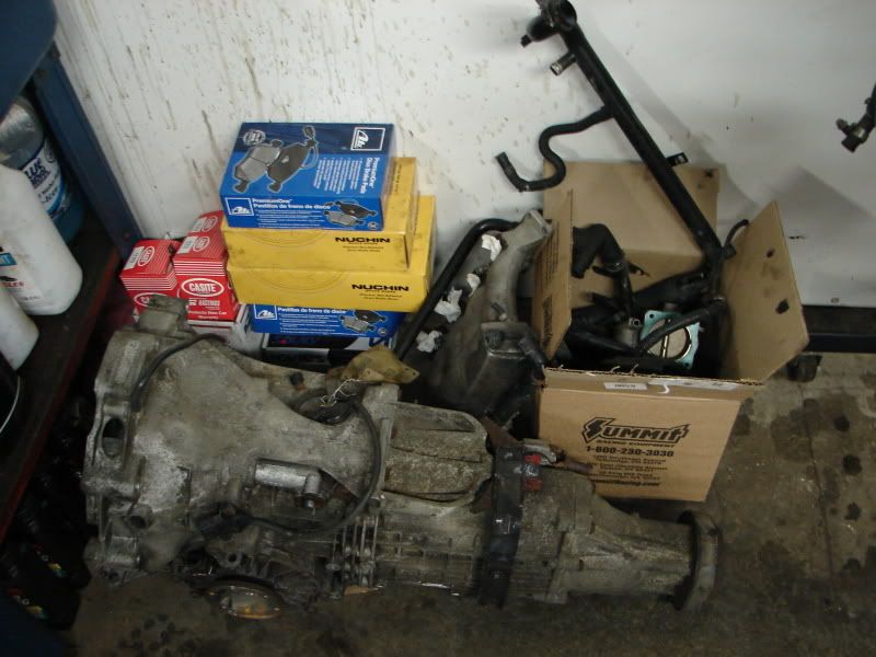

Got a bunch of motor parts. cheap! stock injectors,fuel rail, intake manifolds etc. Just ask

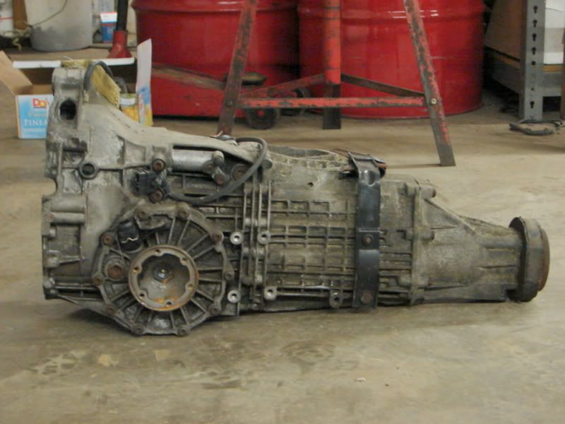

Took some pics of some of my parts tonight. I will include the prices that I paid for them and what car they each came off of:

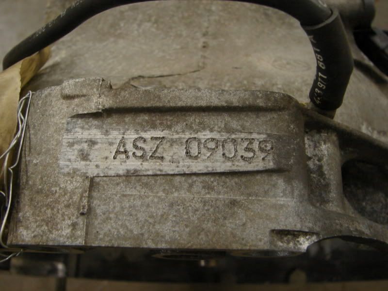

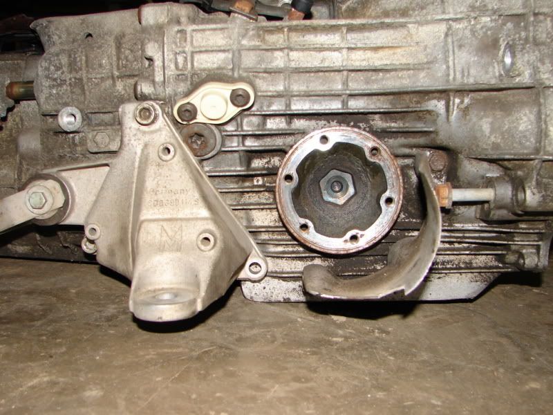

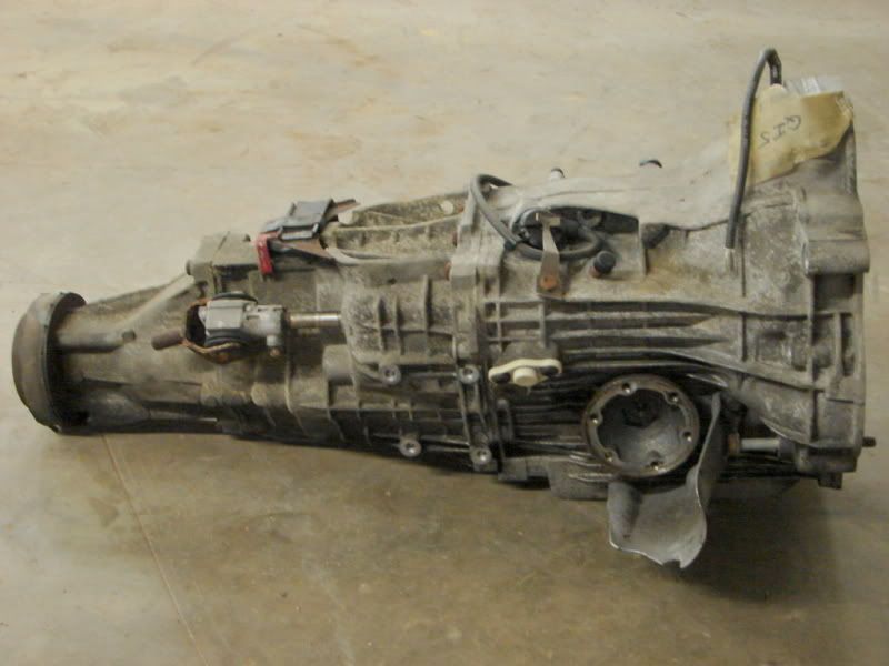

5-Speed Transmission (code ASZ) from a 1991 Audi Coupe Quattro: $212
This is the magical piece that makes this swap cheap. You can read more about this decision in my previous thread:

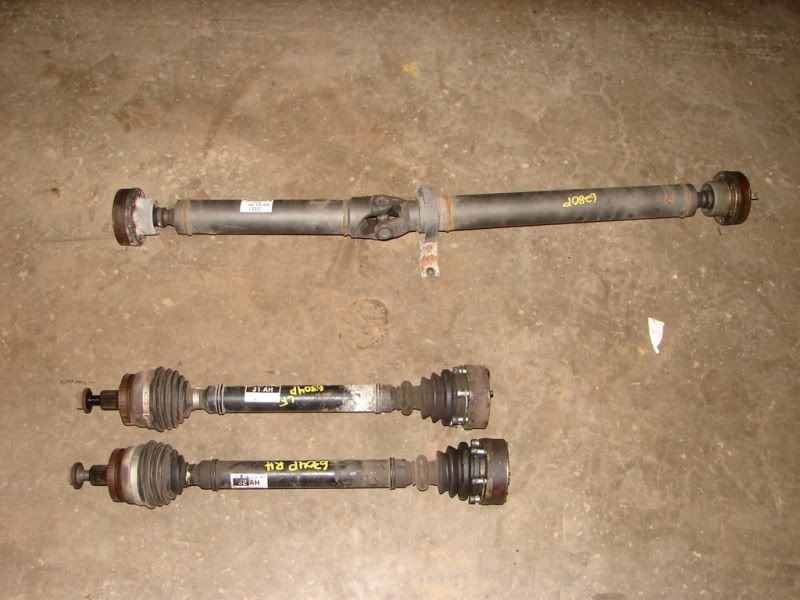

2 front axles from a 2000 Audi A4 2.8 Quattro 5-Speed (with bolts!): $55 for the pair
1 Drive shaft from same car: $60

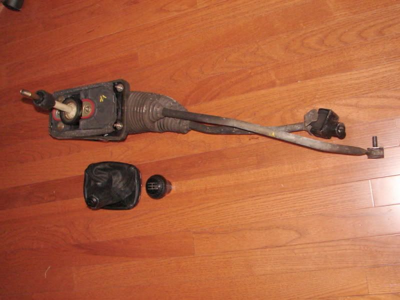

Shifter box from a 2001 Audi A4 1.8T Quattro 5-Speed, including knob and boot: $50

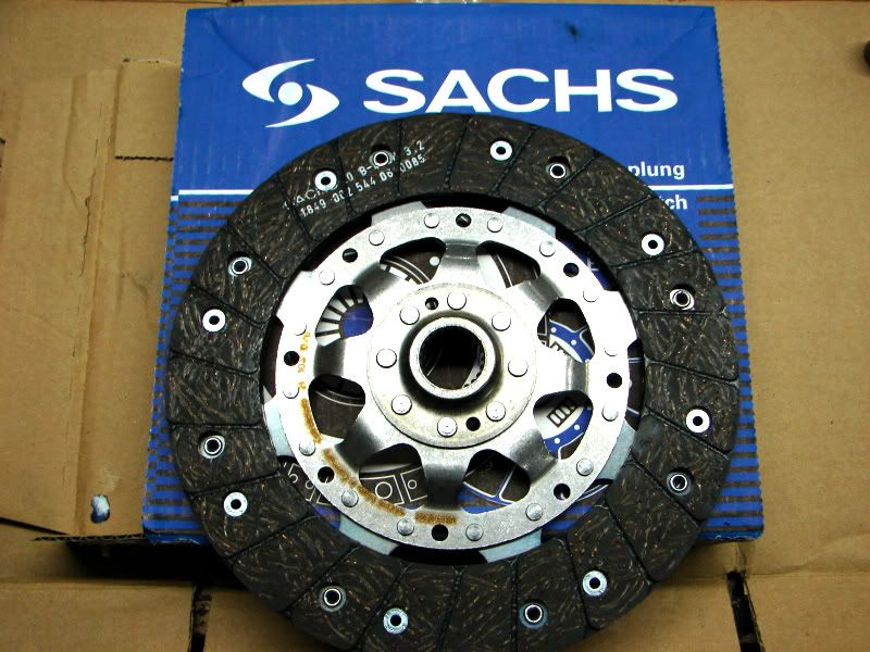

New Clutch disc, SACHS SD80189:

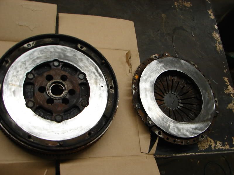

Used B6 Dual Mass flywheel and pressure plate, freshly ghetto-resurfaced:

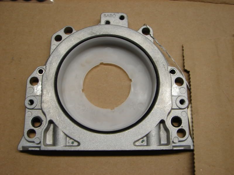

Rear Main Seal w/flange:

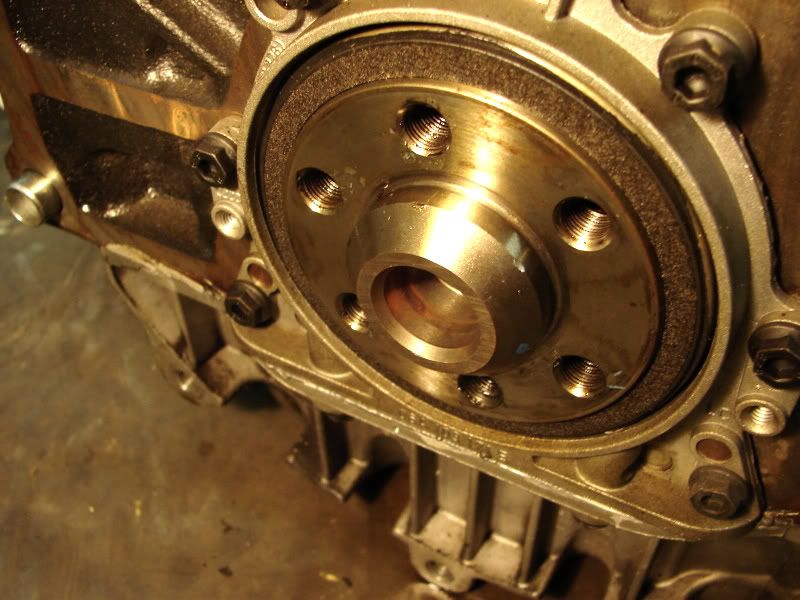

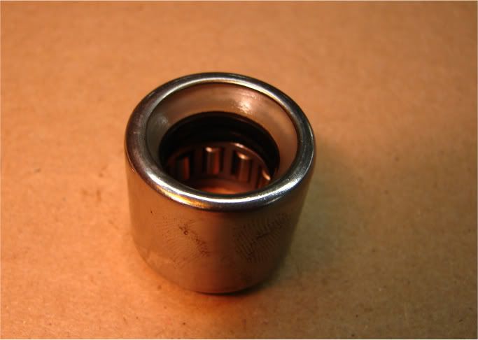

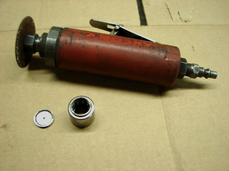

I spent today working out my Pilot Bearing "Situation". And a situation it was! As you can see, the B6 Flywheel (and likewise the ATW and AWM 1.8T flywheels) do not have a simple 43mm hole in the center. It tapers down to a 29mm hole due to the integrated center-bearing for the Dual-Mass operation.
Therefore, I do not have the luxury of using the special-order bearing like Biketsai did (which is by far, the best documented fix for this issue). I am working on as-yet undocumented alternative pilot bearing solution. I don't want to share anymore until I verify that is going to work 100%. Hopefully I'll have details tomorrow.

Im actually really interested to see what you do for this FW situation. On another swap I did over winter break, my friend was given the same looking FW that had the taper, we figure we couldnt use the Zorkos bearing and bang that piece out! We ended up just getting a new FW.

Couldn't you use that same bearing but leave it sticking out slightly? You should have some head room between the surface and the clutch disk itself seeing that your using an offset unsprung disk.
Just have to make sure that the bearing isn't touching the tapered part of the lower piece of the flywheel.

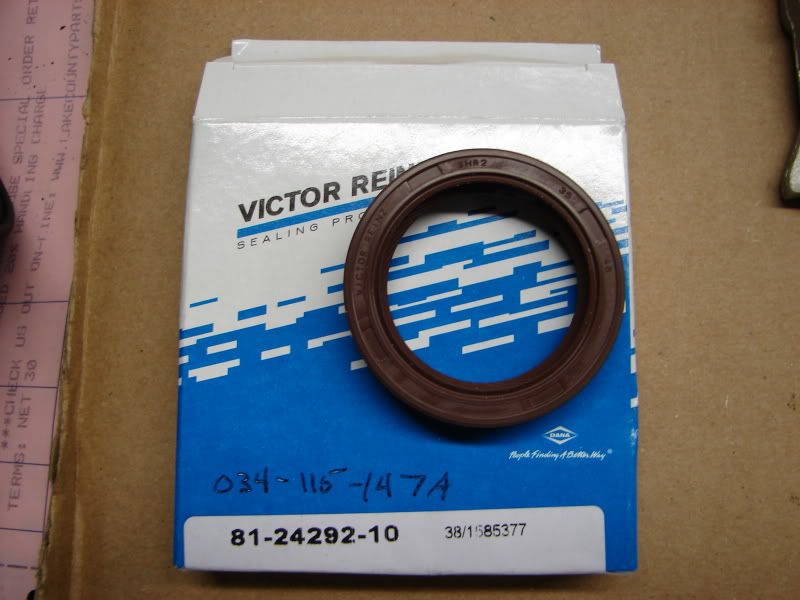

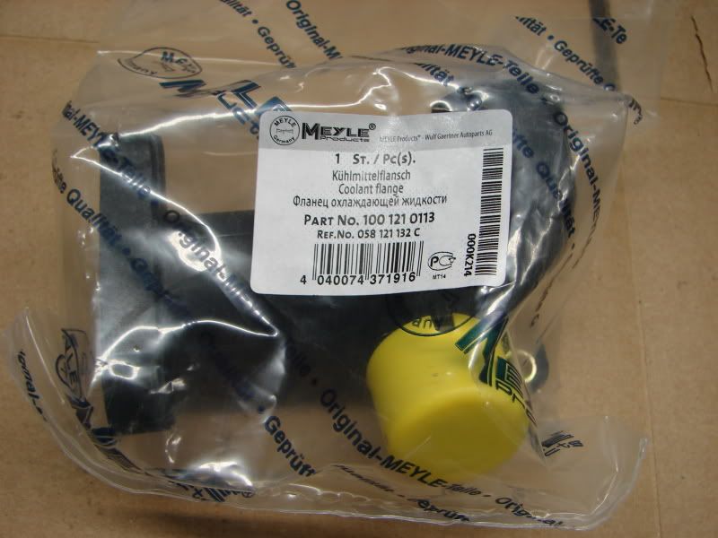

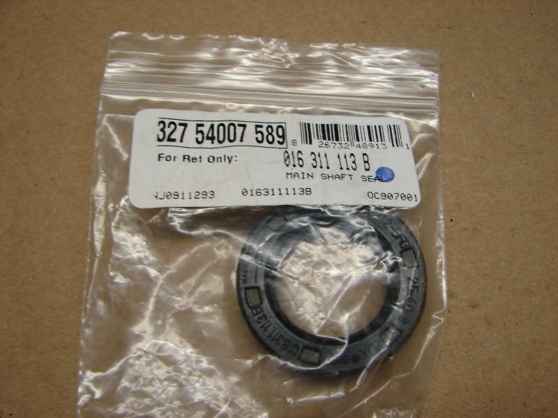

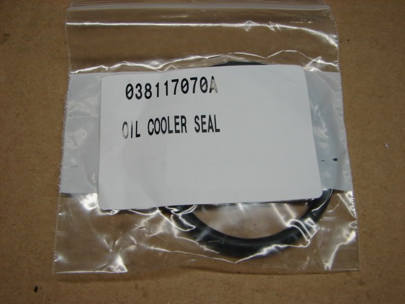

Got some more parts in:
2 Cam seals (PTFE variety):
Oil Cooler O-ring:
Coolant Flange (w/o-ring to block):

Transmission Input Shaft seal:

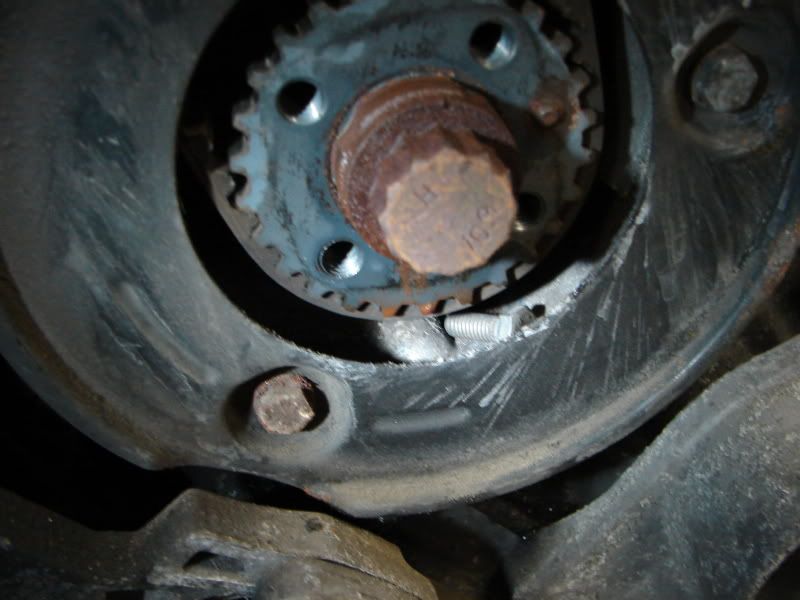

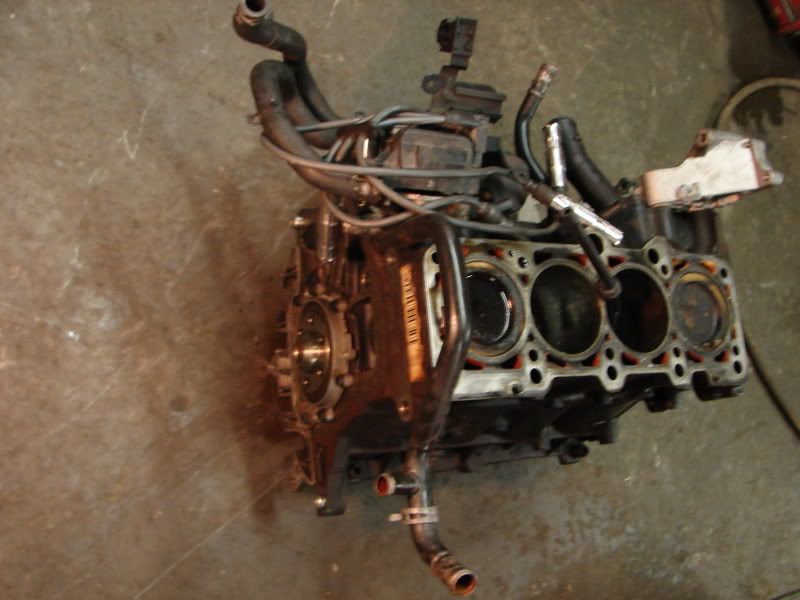

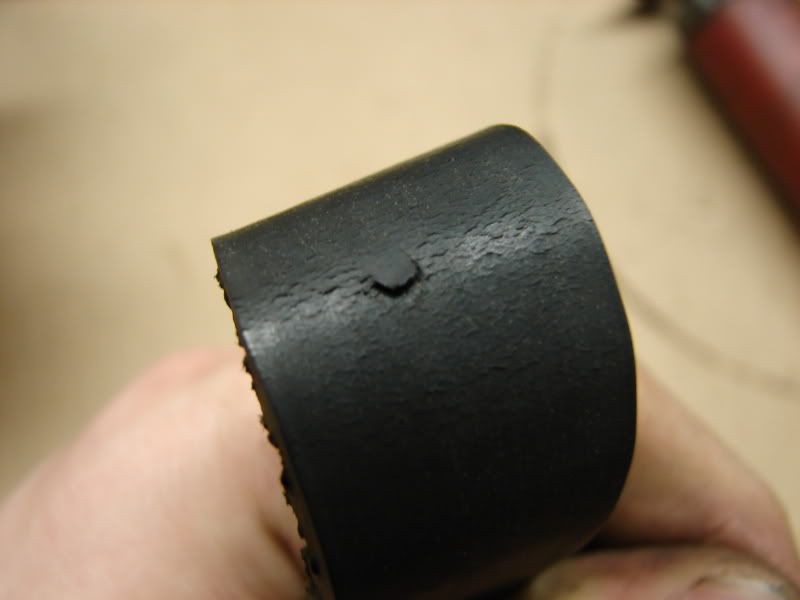

Took some more stuff apart. I was taking the t-belt stuff apart and to my absolute HORROR, I found a loose bolt behind the cover!
I couldn't believe it. The belt had been changed, Aud genuine belt, pump, and tensioner equipment. Also Only 2 (two!) of the 3 water pump bolts were there!. (No, the loose bolt was not a water pump bolt. It was one of the missing cover bolts I assume). It seems like really sloppy dealership work to me.
It looks like it had caused some minor damage to belt in 2 places:

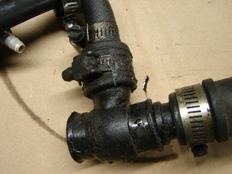

Took some PCV crap off. Nasty, nasty things:

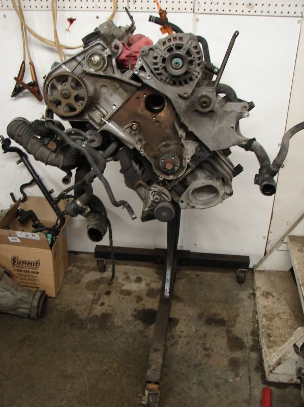

Got the engine on a stand now, with all the parts nestled neatly in my allotted cubby:
Also, I have details on the pilot bearing situation. Read on>>

The photo above is actually showing the backside of the flywheel. Where it fits over the crank, it has the normal 43mm hole. But on the other side (the clutch disc side), there is only a 29mm hole. So there is no possibility of using a bearing of a 43mm diameter.
So what to do? I believe I've devised a workable solution. I should say that I have not invented this method, but perhaps I can say that I am documenting it. I should reference this thread for the hint:
http://forums.vwvortex.com/showthread.php?3125000
Looking at the Automatic crankshaft, you can see there is already a hole there.
I was initially thinking of just pressing in a 1.8T pilot bearing into that hole. Turns out that hole is almost exactly the same size as the input shaft itself - no dice. So my next thought was to see if that center section was removeable. A quick check in ETKA shows that is indeed the case: the bushing has a separate part number. A slide hammer made quick work at that, thanks AutoZone!
That leaves me with this, now somewhat larger hole in the end of the crankshaft to work with:
Turns out that hole is now too BIG for the 1.8T pilot bearing...GREAT. So now I'm thinking about getting the Torque Converter bushing machined to receive the pilot bearing, when I realize that I may have a DEPTH problem as well...DOUBLE GREAT. Luckily, I had a grenaded Jetta 2.0 liter block sitting in the shop with which to compare. It is from an automatic car, but on the transverse cars, all the cranks are like our manual ones:

I was able to ascertain that the leading edge of the pilot bearing in a manual car starts about a 10mm positive offset from the bolt-up surface. The "snout" sticks out about 13mm, and the pilot bearing is usually pressed in about 3mm into the snout (there is a beveled inner edge there). So I knew what I needed to create, but how? On my Auto crank, the snout does not protrude. If a bearing was installed in a similar way, it would end up at about a 0 mm offset from the bolt-up surface. This is a problem. A bigger problem is I have no idea what bearing I'm going to use. So off to the interwebs, and the above mentioned vortex thread, on the 10th post someone mentions that they had used a V6 pilot bearing.
At this moment I am racing around the shop trying to locate an Audi V6 pilot bearing. We just happened to have one, brand new! How lucky is that? After a quick comparison, the OD is a perfect match to the TC bushing: 24mm. Check it out.
Left to Right: 1.8T pilot bearing, 2.8 pilot bearing, 1.8T torque converter bushing.
For posterity - the corresponding part numbers are, left to right: 056105313C, 034105313A, 058105171A:
So that's settled, but what about the depth problem. Even looking closely at the V6 bearing the problem is even worse. The bearing rollers are way in the back of the housing. In fact, they are in the back half of the housing:
I know realized what that post on vortex was referring to when it said "cut it down a bit". I quickly grabbed a cut off wheel and went to work:
By cutting the back cap off, I could now install it backwards. After some intense measuring I decided I would have to install the bearing only part way. Slightly more than halfway is what I came up with:
I paint marked the input shaft to where I though the bearing would end up at the final install depth and did a test fit of the transmission (no flywheel or clutch at this point. My measurements were right on the money and it looks like this will work very nicely. This is a relief and I can now sleep at night knowing that the swap progress can continue.
Thoughts?

I like your ingenuity. Is this trans similar in mounting and length as the 01A?

that pilot bearing looks like it is still sticking out pretty far. but you said you did a test fit, so I guess you're good.
It is a 01A, just out of the older model Audi.
Yeah, I know. I measured it at least 5 times. And I still did the test fit. There is a nice window on the top of the tranny to see the input shaft and bearing, so I could verify the depth was correct. On the manual crankshafts, the 1.8T pilot bearing actually sits completely forward of the bolt-up surface. This is due to the "snout" being so long. So that is why it sits forward like that on the auto crankshaft.

Looks like it should work!

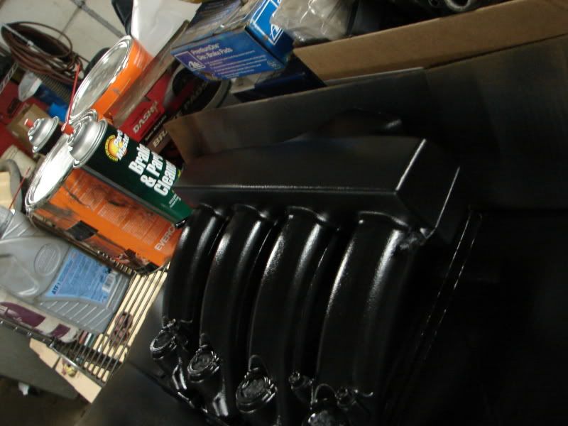

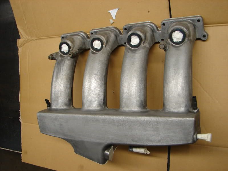

Painted my Intake Manifold tonight:
Cleaned and sanded just a bit:
And primed, and painted. Semi-Gloss Black:
I think it turned out pretty swell. Still a bit glossy in the photo as it was still drying. I'm doing the Valve Cover tomorrow evening.
