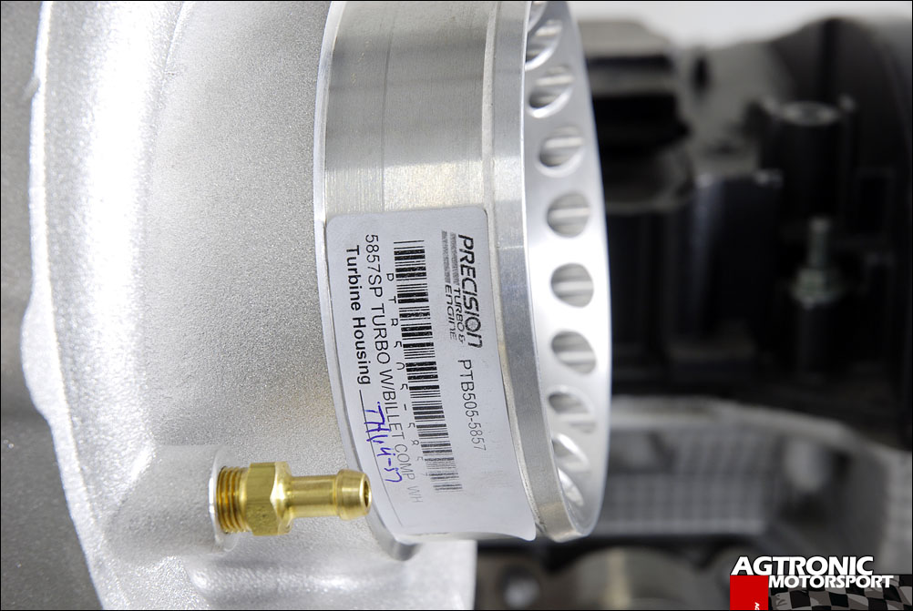

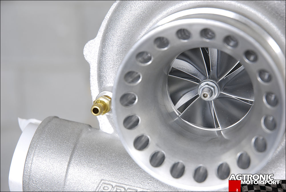

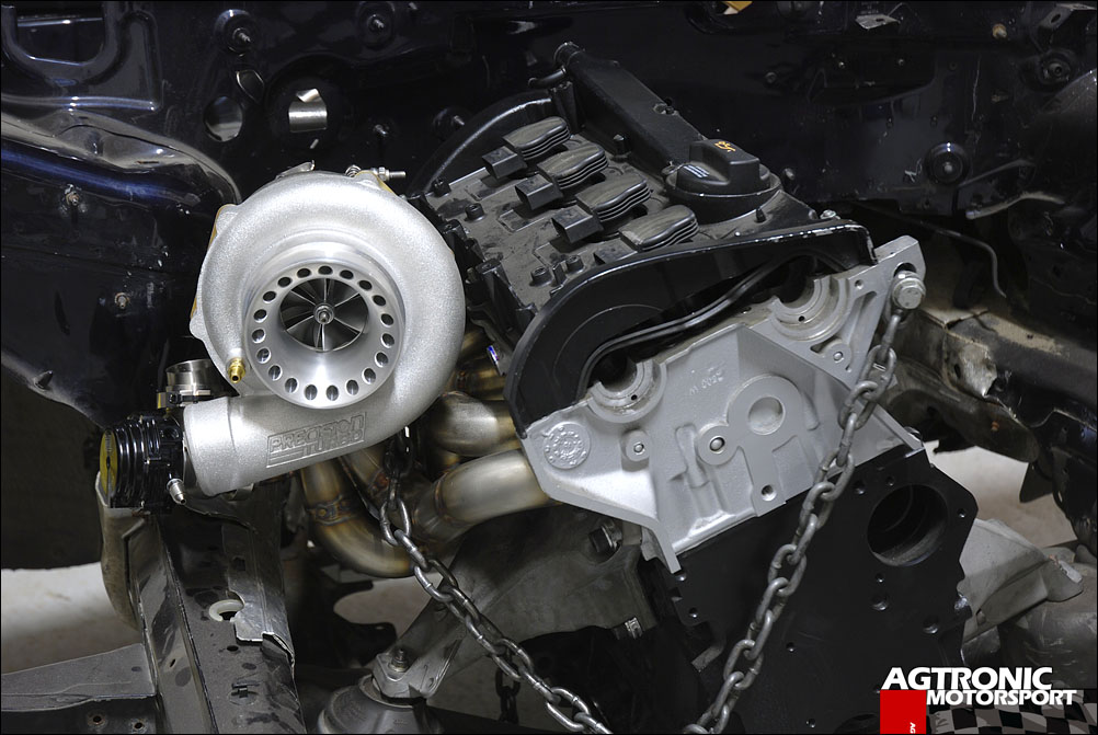

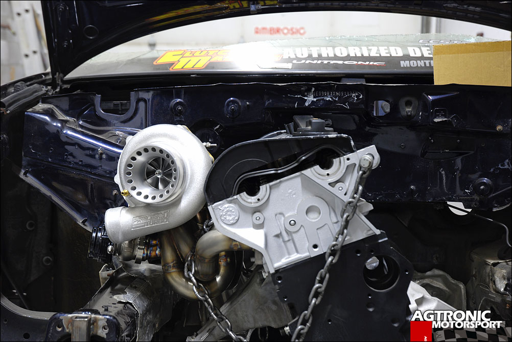

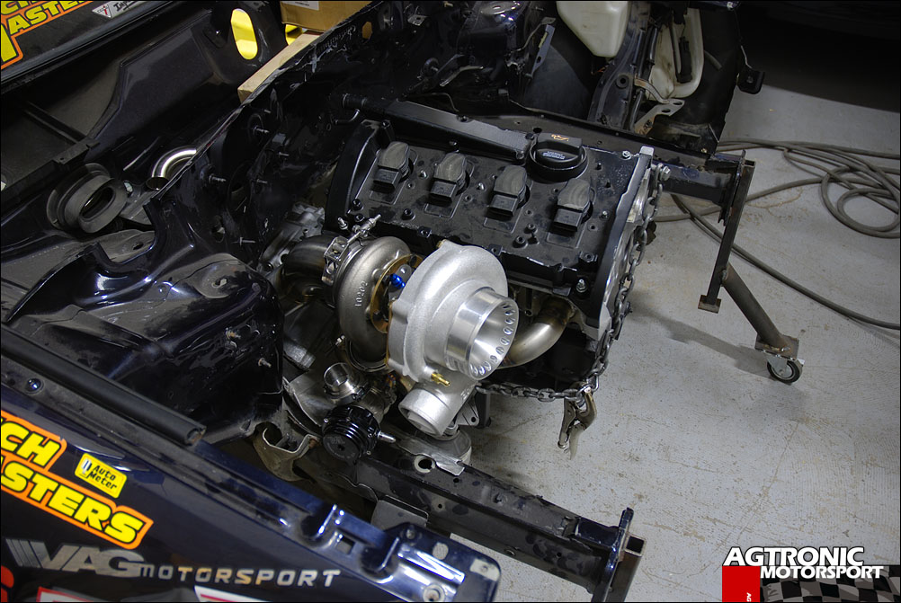

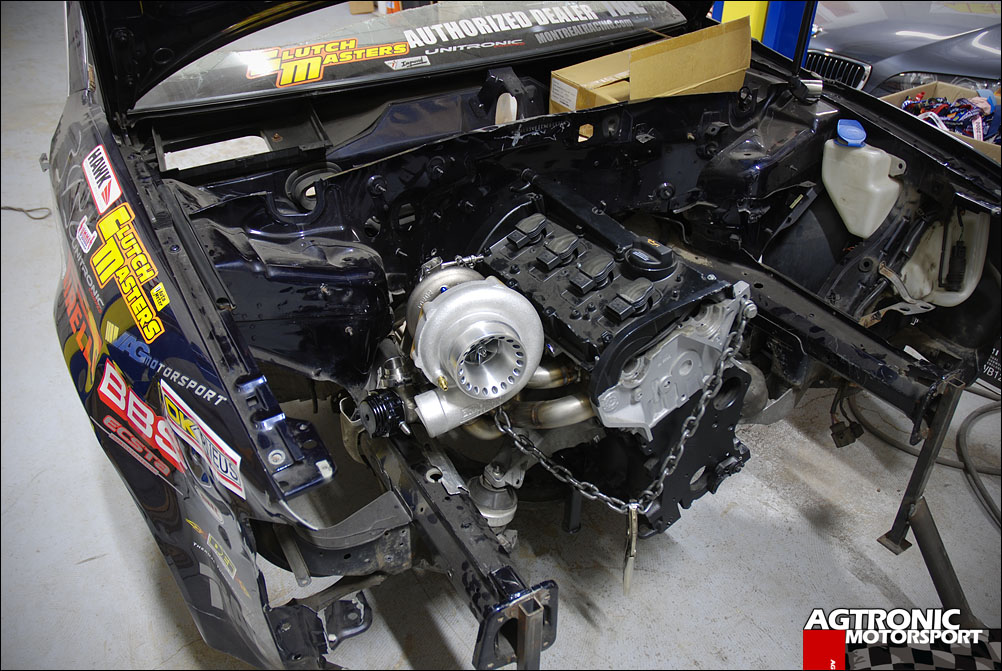

    I have been doing the PM thing for awhile now on my build so I thought I would just start my own build thread. I just received a few pics from Markku over at Agtronic. Thought some of u guys might like these pics.

    Engine:
    Built head with Ferrera Valve set
    255 walbro fuel pump
    mahle pistons (8.5:1 cr 20mm pin 84.6 Bore)
    Eagle Rods
    ARP Head Studs
    APR Engine Snub Mount
    Precision 5857
    Agtronic Manifold & DP
    TiAL 38mm V-Band External Wastegate MVS
    Tial 50mm BOV
    1000cc injectors
    Eurodyne Maestro 7
    Drivetrain:
    Southbend Clutch
    The motor is already built and I have the rest of the parts in the closet just waiting to go on.

    Shayne, don't worry about the PTE. First, we will take care of you if you experience any issues, and second, we have sold a few of these. First 5857 started to blow oil, and PTE replaced it no questions. We now run a restrictor at the feed line despite PTE assuring us there is no need for one. We no longer have smoking issues on any of these. I think 100+ psi is too much oil pressure for any turbo. The power and spool are great on these. Great value IMO.

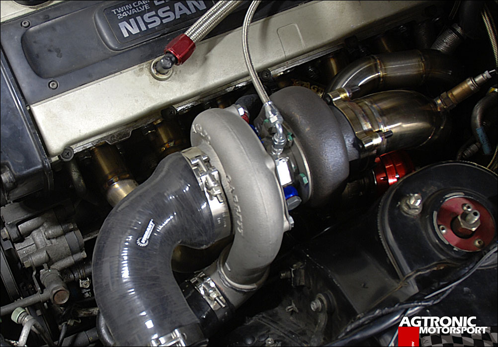

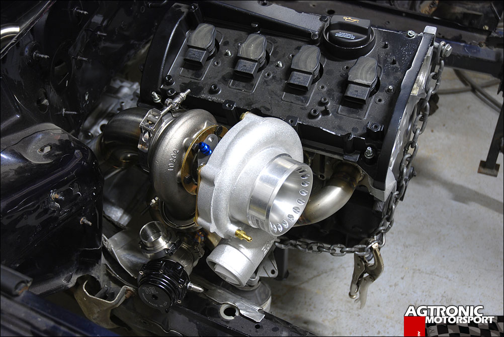

    I bought blank oil feed flanges and drilled them out to .065 for the 5857, ever since Dan's has blown 3 times then we got to talking about how its just a t3/t4 and Garret requires a .065 due to the oil pressure.. After Dan fighting with PTE various times, he finally said fuck it and ordered the restrictor, which has stopped his oil blow by issue (well, CHRA would squirt oil)...
    But they def lack service. Read my build thread, last page, towards the top, as to what Wes told me when I sent the 5857 back to them unused b/c it made a noise (grinding/tinging) and would something catch something stop spinning by hand
    '00 Nogaro S4 - TIP, Ebay turbos, Ebay inlets, Ebay stage 2 tune, OBX manifolds, OBX exhaust

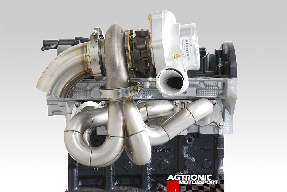

    Shayne, the DP is done and now we're on the reroute portion.

    Anyways, to keep the install CLEAN.. i did this... 1.65mm = .065 restrictor
    now -an fitting goes right on without the ugliness of a fitting screwed into the turbo nd then a line screwed into it.. IMO.

    black99.5a4, the fitting we make is a male/male fittings, which is not much different from the ones used on GT turbos. Personally, I prefer not to rely on a gasket to seal a pressure line. Also, having these turned on the lathe is inexpensive. I don't find it ugly. Maybe you're picturing two fittings there ...
    Standard restrictor fitting :

    In the past I have used 0.045 for T-series turbos, and am using .05 on the PTEs. I haven't decided what to use for the final run of restrictors though ...

    Quote Originally Posted by Shayneduboulay View Post
    Markku,
    Can you take a photo like this with the hood closed to see clearance with the compressor housing? Curious to see.
    -Doug
