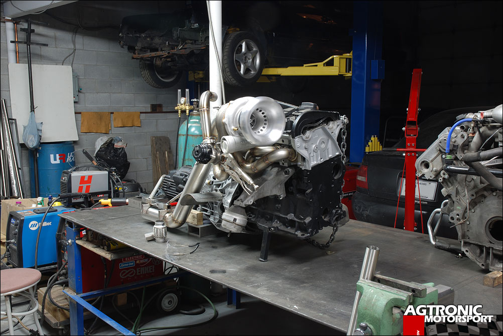

  11. #171
    Senior Member Four Rings Wet0willy01's Avatar
    Nov 17 2008
    35356
    05 USP, 68 Camaro, 00 Cavalier
    Lancaster, PA
    This looks good...
    this looks better...

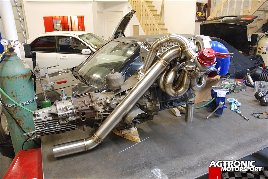

    Quote Originally Posted by Wet0willy01 View Post
    That downpipe looks a little low. Mine sits down around there and I hit it on everything because it is lower than the subframe. I hate it and can't wait for the day I decide to spend money on new custom turbo-back exhaust.
    -Doug
    2002 A4 2008cc GT-3076R turbocharged Avant
    397awhp/371awtq on straight 93oct and 96*F ambient
    Tuned by Autospeed Performance
    I am selling an Authentic B6 Sportec Front Bumper. PM me for info.
  17. #177
    Nov 17 2008
    35356
    Lancaster, PA
    This is pic of Shayneduboulay's down pipe... Look any better?

  19. #179
    Dec 03 2005
    9070
    audi, chevy, jeep, lots and lots of bicycles
    connecticut
    still looks low to me. it'll probably fit but I'd like to see it relative to the chassis and the front subframe.
