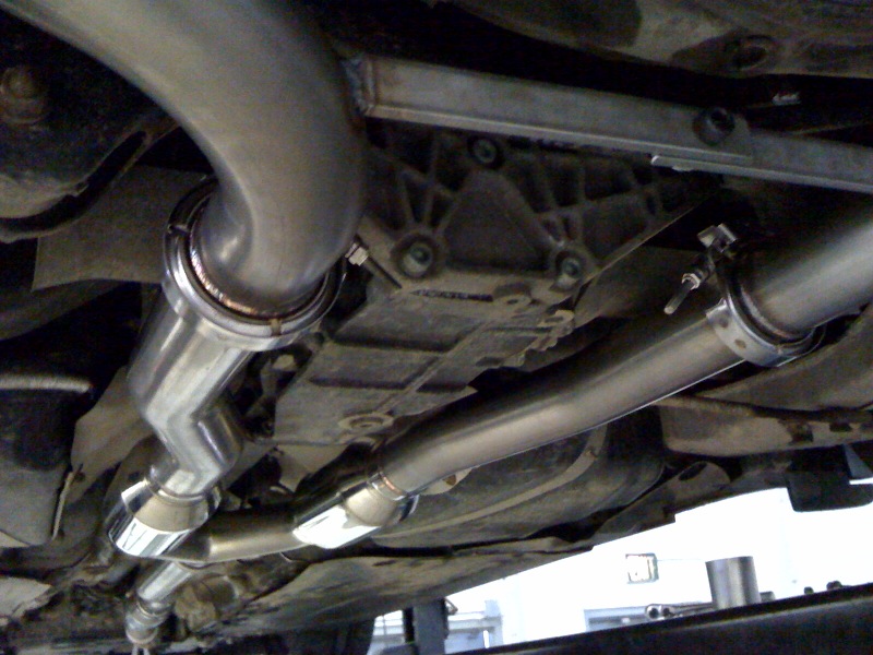

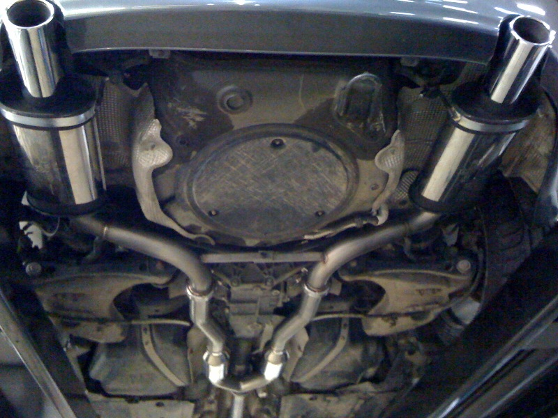

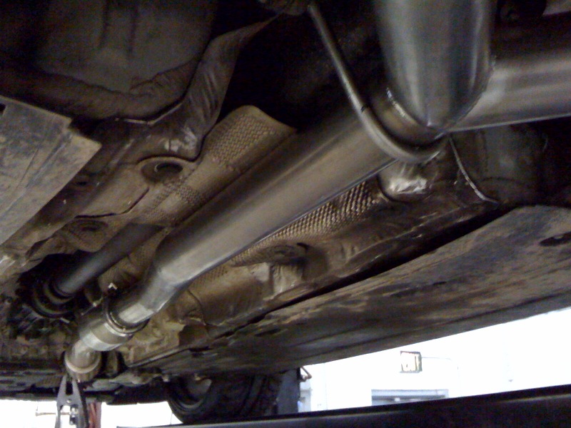

shifter linkage and rods in, along with prop shaft:
my original prop shaft, with Milltek exhaust:
