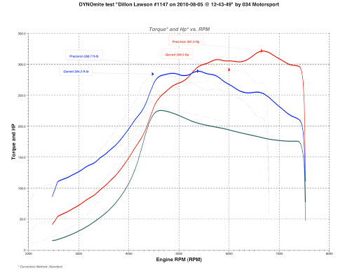

    Here are the sheets:
    It looks we are making boost about the same place, 4600rpm. I have some constraints with my intake and intercooler setup, my intercooler and piping is too small. We are also thinking about trying out an electronic controller versus the Halman pro to address the boost fall off. I have had boost fall off problems for the last couple turbo's i have tried. The dashed line is a 2871r with the same motor. More to come.

    I have a Halman also, boost holds good. I had a problem with my 30r tapering boost before my 5857. Both are .63 a/r, guess the smaller turbine of the 30r was choking up with my setup and making boost fall to 26psi no matter if I turned it all the way to 33psi.
    Interesting the ball bearing didn't do any better than my journal and the same spool between the two is exactly what I suspected.

    I used a Haltech boost solenoid before the Halman and it held boost to redline. I will give an electronic a try.
