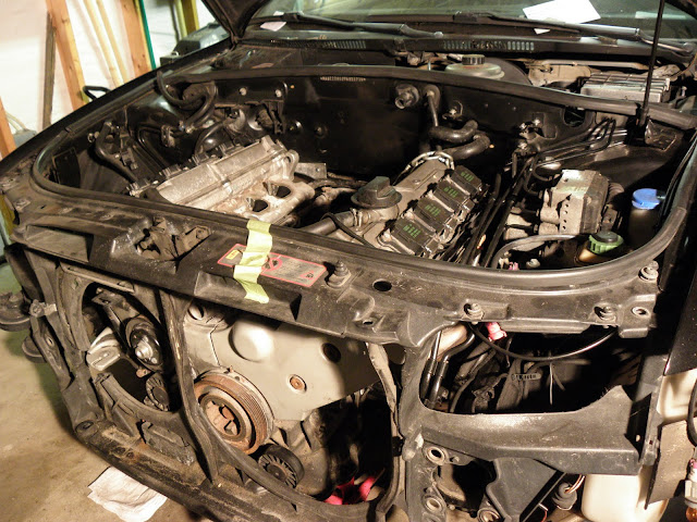

    After seeing siena do the v8 swap last year, I decided that I wanted to do one too.
    So, first I acquired the following(shown here partially disassembled for timing belt replacement):
    Then, I needed a car for the swap, so I picked this up:
    Last night, we accomplished the following:
    Will hopefully be acquiring the 034 flywheel insert and a southbend clutch/pp, along with VEMS, wiring harness, and fuel rails from EFI Express in the near future.

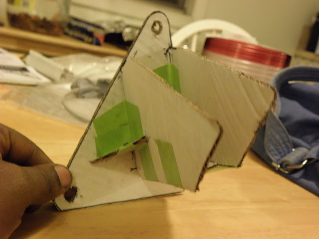

    got my custom fuel rails and harness/ecu from efiexpress a couple weeks ago. engine is basically ready to go back together, will be putting the lower end back together tomorrow night(nothing exciting, just new oil pan/oil pump cover gaskets, main seals, etc). clutch from clutchnet, flywheel insert from 034 arrived a while back as well. i'm working on the motor mount designs as well, will be waterjetted out and tig welded.

    When you make the motor mounts will you be reproducing them?
    Senior Member Three Rings Castor Troy's Avatar
    Dec 17 2008
    36485
    Billings, MT
    that is the plan :)

    no pics because i was lazy, but i got the oil pump cover/pulley back on, water pump and thermostat, and did some cleaning of the block. going to harbor freight tomorrow to get a seal puller to remove the 4" diameter rear main seal, and then i can put the oil pans back on.
    heads are gonna go the shop on monday to get cleaned and decked if necessary, and new valve seals installed.

    Here is a picture of my Driver side/left mount mock up. I finished it a while back just didn't take any pictures.
    Also this is what I did for the passenger side mount, added a gusset to the top side.

    very nice. did you use a v6 subframe/engine mounts?
