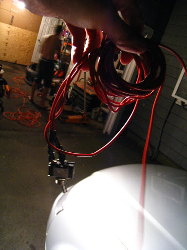

    -My headlights would turn on if i applied the brakes, and if i turn on my fog lights while applying the brakes it will turn off. [Solution] - Removing Jake's ghetto starter switch may have fixed this electrical gremlin, possibly from clearing all the codes as well. This issue is not present anymore after the tail light was fixed and the clutch pedal starter switch interrupt circuit was jumped out.

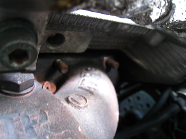

    -Exhaust manifold bolts loose or fell off due to reusing old fasteners or improper torque down. We aren't talking about a few, we are talking probably 8 of the 13 were loose or have fallen off [Solution] Buy new fasteners from the dealer, bend my own wrench, take turbo out and put new fasteners in.

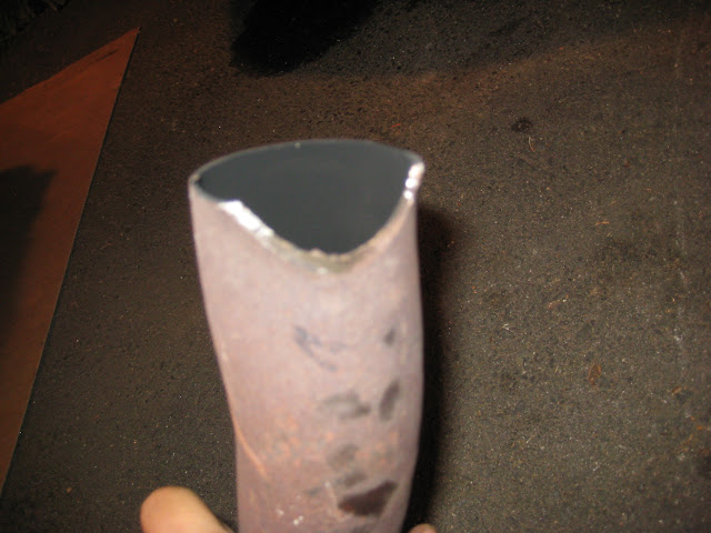

    - Open downpipe exhaust. My car had a full exhaust when delivered to Do Werk. I was told the downpipe I had did not fit and clear the manual transmission rear crossmember. Jake's solution was to cut the downpipe out and leave the car with just a testpipe and 2ft of open downpipe. A recommendation of fabing up a new downpipe for the manual crossmember was not provided. Not sure if it was because I said I am going to get a new exhaust made once I get home or if he just didn't want to do the job. [Solution] Doug was worried for my hearing on the 13hour trip home with no exhaust. He was also concerned about my new engine's longevity given the other assorted issues we could not fix. As a result, he removed the open downpipe and installed Greg's (actlsub9) old MTM exhaust on my car since Greg's car was at his house and is currently being parted out due to an accident that totalled the car out.

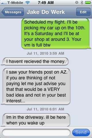

    Threats
    I'm usually not one to be so critical, however this situation has escalated beyond my comprehension. On the evening we picked up my car (when we were not aware of all the problems), I told him I didn't just bring a large chunk of money on my trip and ask if he takes credit card. Apparently the infamous Dowerk garage doesn't even have a CC machine, so I told him I would paypal him either tonight or the day after, as I had a long day on the flight, waiting for him to get to the shop, and soon to discover all the problems with my car. Jake had the audacity to send me this text message the night of.
    Doug's dog woke him up at 6am and he saw an unusual vehicle in his driveway that he did not recognize. It scared the shit out of him seeing as he has a lot of money in cars in his driveway (3 modded B6s and a few other vehicles). Turns out it was Jake and his friend sitting in Jake's mother's car waiting for us to wake up so he can watch me pay him. Doug did not have a text message or voicemail from Jake explaining that he was outside his house so Doug almost called the police before he realized who it was. Jake said he was not going to ring the doorbell but sit in the driveway until we came outside to work on my car. Can you say creepy or even better… paranoid?
    I had no intentions of not paying the bill, and both Doug and Tu can attest to that. With that said, you can see his professionalism in the industry.

    Cliff's for those who need them:
    Shipped car to RI - DoWerk Garage 11 March 2010
    Vinny bought 2.0L Engine from Doug (not affiliated with DoWerk)
    FAILURE LEVEL KEY:
    *Damage to vehicle due to incompentence/shoddy work
    **Potential for extensive damage to drivetrain/electronics
    ***Major safety issues
    +Possible/Likely Swap issues.
    +Rigged clutch starter interlock.
    Left dash apart.
    *Head unit out. Needed rewiring
    *GPS Antenna wire cut.
    ***Rear brake light not working. Connector loose.
    ***Headlights came on with brake application. Short circuit or miswire.
    ***Exhaust manifold bolts not tightened properly due to old bolts used.
    **Coolant leak at Turbo.
    **Oil leak from Head/Block Interface.
    ***Transmission underfilled. 1 Quart Low. < Voided warranty = $$$
    *Heat sheild left off. Missing bolts.
    ***Exhaust left open at downpipe. No solution offered.
    **Electrical system damaged in several places. Harness connectors broken.
    Cigarette lighter disconnected.
    +ECU was left uncoded - no match to new man trans.
    +IAT, Thermostat trouble codes
    Poor communication - only communicated when money was needed.
    Radiator - Existing Auto Trans would have worked - man trans replacement demanded.
    Raced vehicle on the street with low trans fluid and open exhaust.
    No licensed copy of VAG COM.
