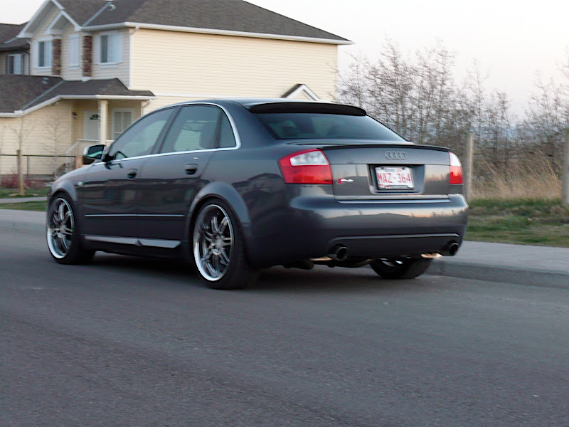

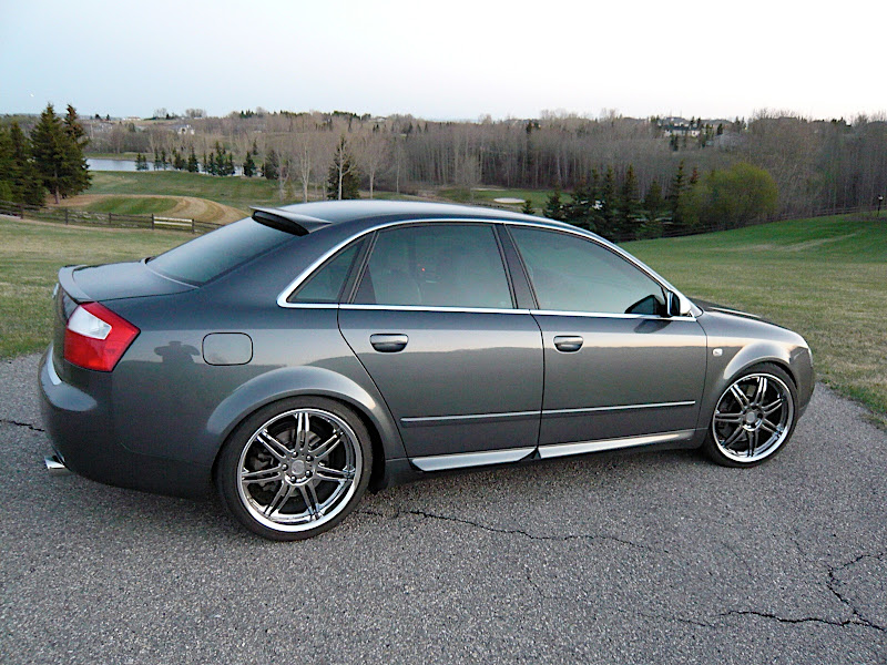

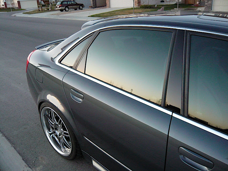

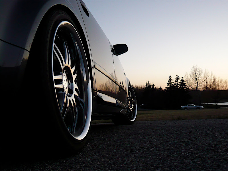

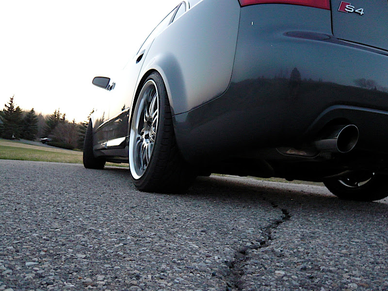

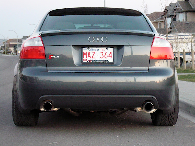

    I'm running 235's on 19x9's and have a slight stretch. You won't have any I would guess on an 8.5" rim.
    As for the ride and stuff, they will all be within millimeters of each other, you won't notice a difference. It may just be easier to curb your rims.

    Quote Originally Posted by staticuxo View Post
    do you have any pics? i'm about to pick up OEM RS4 wheels which are 9" wide and i planned on stretching a 235/35 but i'm also thinking about a 235/35.. thanks!
    Sure thing!
