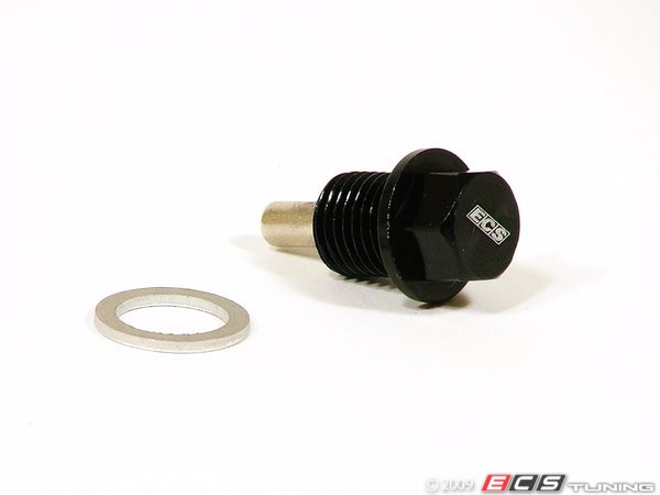

    6.) Install Drain Plug
    a. Discard old drain plug seal (mine would not come off so I used diagonal pliers to cut it off).
    So I took my audi to Just Tires (yes, they do oil changes). I've known the owner for probably 8 years and never had any problems. Does the rotate and balance for me too. I get home and 1 day later find this in my garage (car has 20K miles on it):
    Obviously I took it back. They said the oil pan plug was causing the problem and as soon as they turned it the oil came gushing out. They DID NOT replace the old plug seal, and said they couldn't get it off if they tried. Now I saw where the OP had to cut their's off? Is this really what we need to do EACH oil change? And where do you get the new seal? Just curious because I think (and hope) that this was the problem. All threads looked fine.
    Any help would be much appreciated. I now have to probably redo the oil change myself.

    The crush washer does not come off the drain plug. It's designed to replace the whole plug. I suppose you could cut it off. You can buy the plug/washer for about $2 or source a separate plug, like the magnetic plugs and just replace the washers. Either way, it's small change.
    Concerning tire rotation, it 's a good idea to rotate but you don't need to re-balance. I tend to rotate mine about every 8k km and do it myself.
    Jim
    2011 A4 Avant quattro tiptronic

    I only had issue with the washer coming off first oil change (from factory) and have not had an issue since.
    No need to replace your drain plug every time.
    And FYI... even if they did re-use the old washer, there should not be any leakage like that, unless they just plain forgot to tighten the plug or stripped it out completely. Either way, that little issue would make me seriously question ever letting them work on my car again.

    I bought myself one of these and a set of 10 crush washers.
    http://www.ecstuning.com/Audi-B5_S4-...n_Plug/ES5385/
