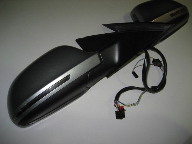

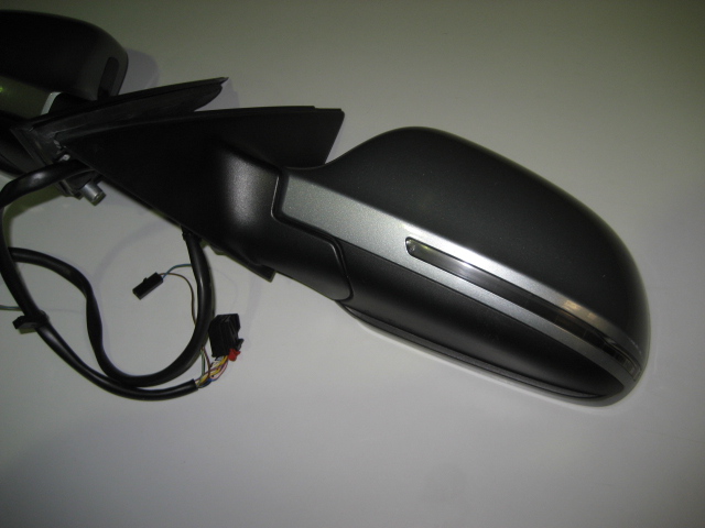

    Can someone confirm that these mirrors are for an 09 and not a 10+? I just want to make sure before I buy them.
    Thanks in advance.

    I would say MY2008-09

    OK thanks, I thought so. I've been trying to check out peoples pics and it appears that with the 2010+ the turn signal is in the bottom black part whereas with the 08-09 they are in the body colored part but there are so many different options I wasn't quite sure.

    You can also see it where the mirror fold - on 2010+ it will do it in a angle of 45 upwards.
