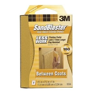

    Materials used:
    -100% Acetone stripper
    -Scouring pads and old rags
    -3M Wetsanding blocks (150, 220, 320)
    -Duplicolor Acrylic Enamel Clear

    To remove the Quatto badge and the ashtray lid button, I sanded the backside with a dremel so that I could pop them out... I believe Audi attaches them via a heat press which melts the plastic on the back to hold it in ... I just sanded through it and it popped right out. If you try to work around it, the results will look pretty booboo. To reattach, I used super glue but any epoxy should work.
    Tips... take your time. 3M wetsanding blocks made it buttloads easier to get the brush going in a uniform direction. I prefer the gloss clear seeing as it keeps the interior looking a bit more classy IMHO ... others like the satin finish for the more sporty look.

    There were no 'brushes' involved in the process. The way it went was:
    1. Lay rags flat on the trim pieces and dump the acetone in, allowing it to soak the clearcoat.
    2. Scouring pad to rub that hot mess off.
    3. Wetsand with the 3M 150 grit block to get rid of the fishscale, which seems to be laser etched or something.
    4. Wetsand with the 3M 220 grit block to get finer brushing lines.
    5. (Optional) Wetsand with the 3M 320 grit block to get even finer brushing lines.... note that some people stop at the 220 and prefer that look
    6. Reclean all parts with soap and water and acetone before spraying the clearcoat.
    7. Spray light even coats from END to END ... never stop in the middle of a trim piece.
    8. Enjoy!
    When I speak of the 3M wet sanding blocks ... they are basically sponges wrapped in sandpaper... THEYRE THE SHIT!

    Appreciate the info! I've used them before when I resurfaced one of my guitars so know what you mean . When I got my car from the dealer the fish scales have had knicks on the drivers side door and a few other places and have wanted to replace for a while but so much more that I can do with 550 than getting the carbon fiber trim at this point though I would like to do down the road. This looks like it is in the price range and a good little weekend job, props again on how it came out. Post up some pics when you get it all installed, looking forward to seeing more.

    Where do you get the 3m sponges? Walmart?
    Active Member Four Rings Tusin's Avatar
    Mar 16 2009
    39967
    Anchorage, AK
    Wait are you talking about these?

    Quote Originally Posted by Tusin View Post
    Yeah! It's pretty much like that. Except those are the trapeoidal shaped ones. You'll want the rectangular shaped ones.
    You can get them from the painters section at a Lowe's or Home Depot or similar shops! They're about $3 per block... and remember get at least 2 150grit blocks (they do the hard work)
