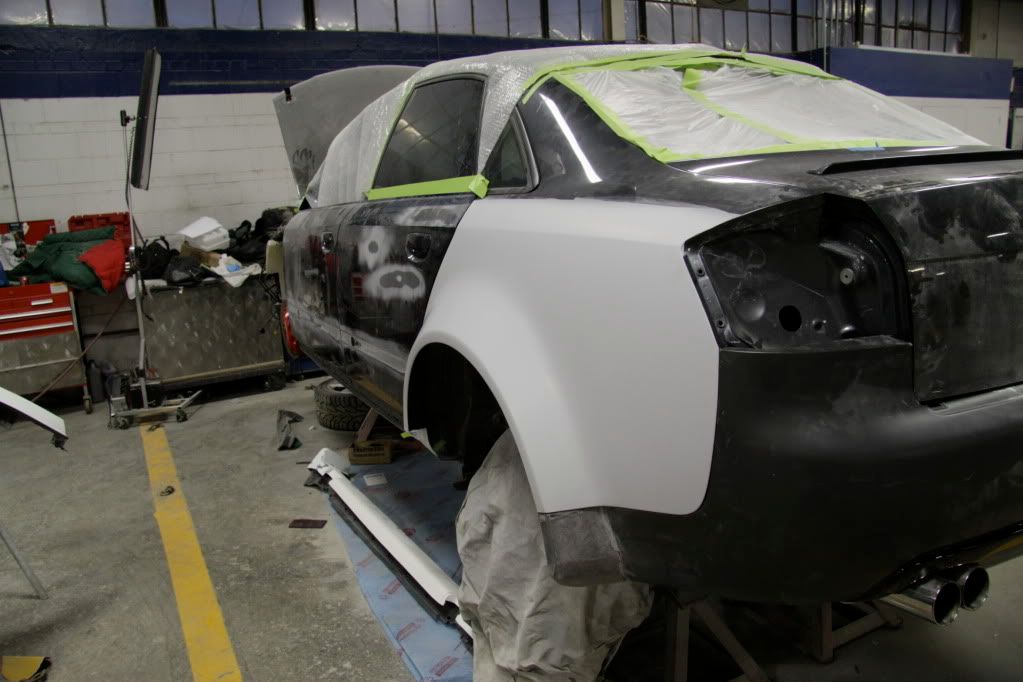

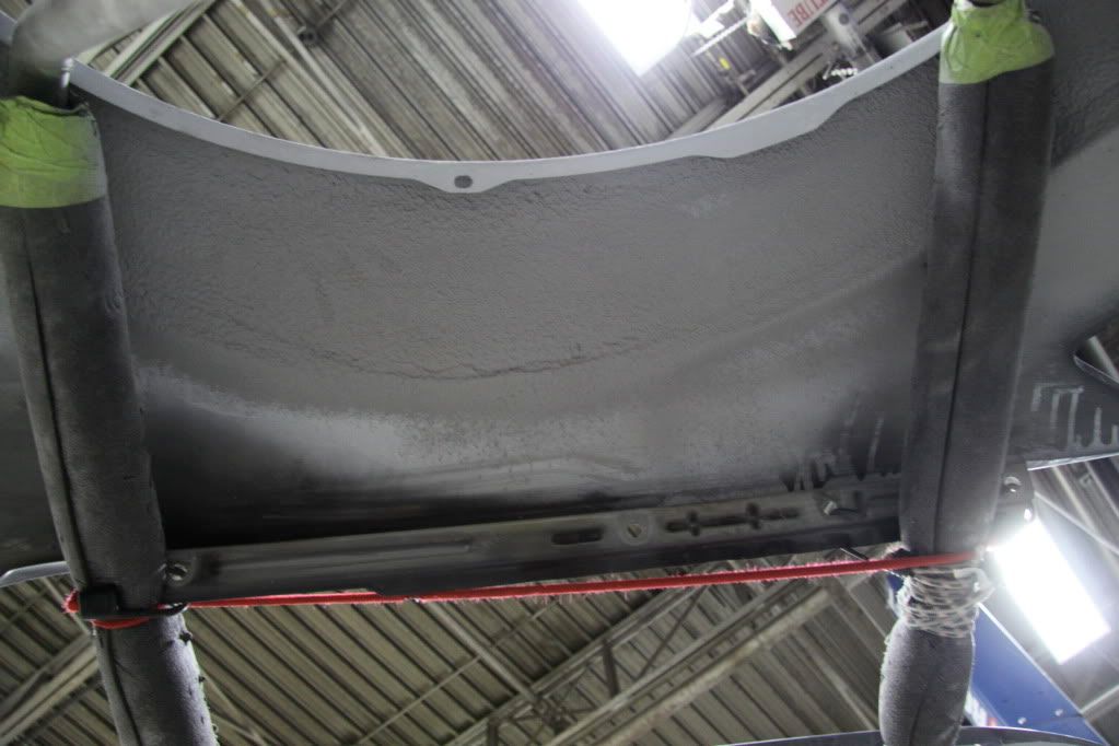

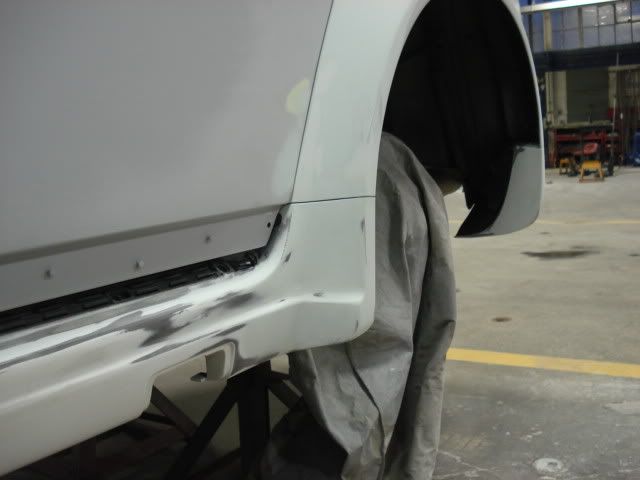

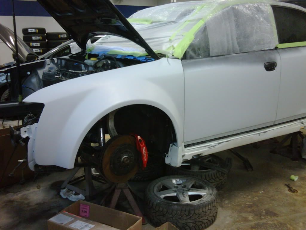

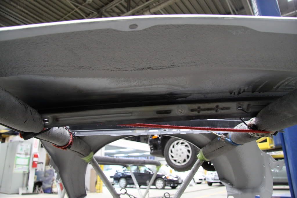

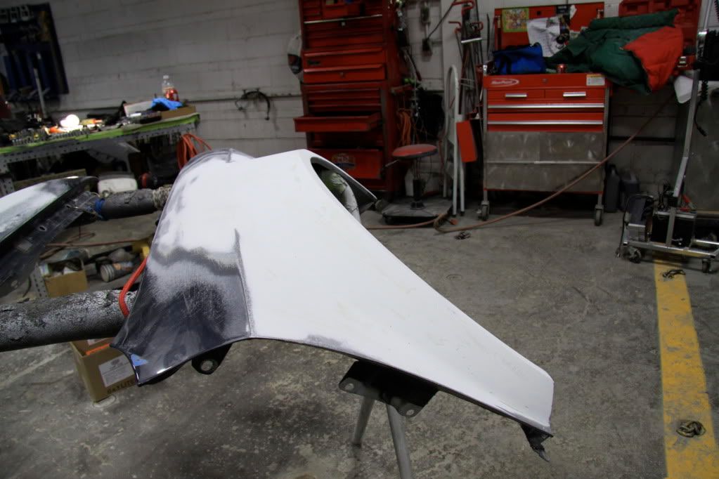

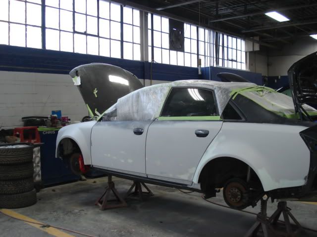

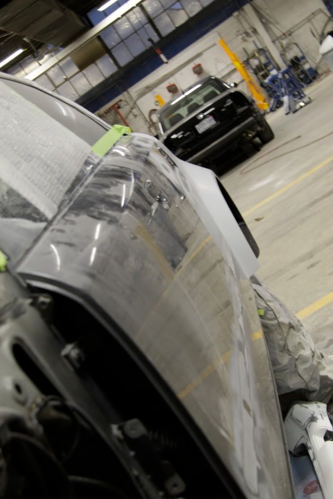

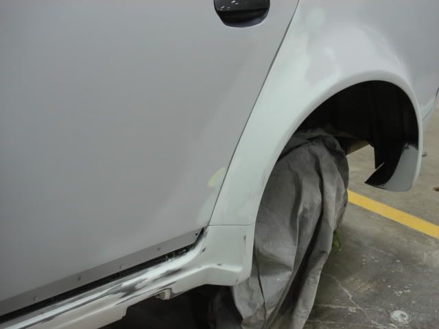

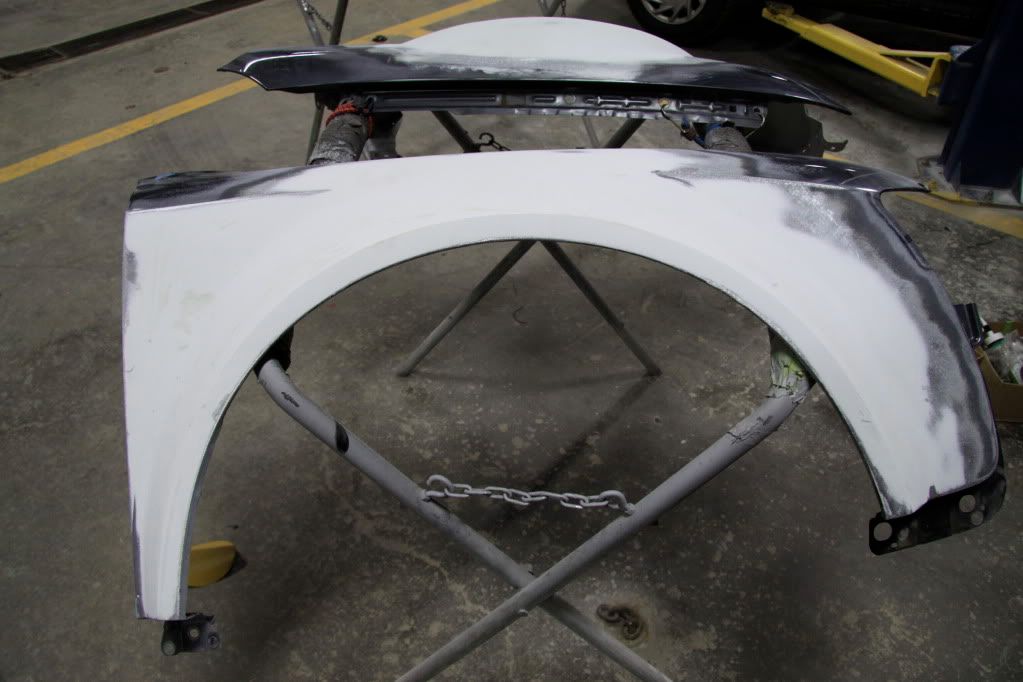

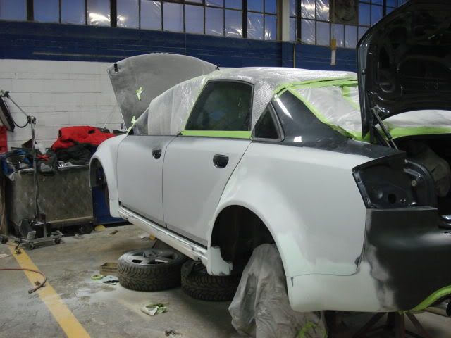

    Wink Warning Exclusive Content–Complete make over… WideBody, Interior, Engine Build, etc..

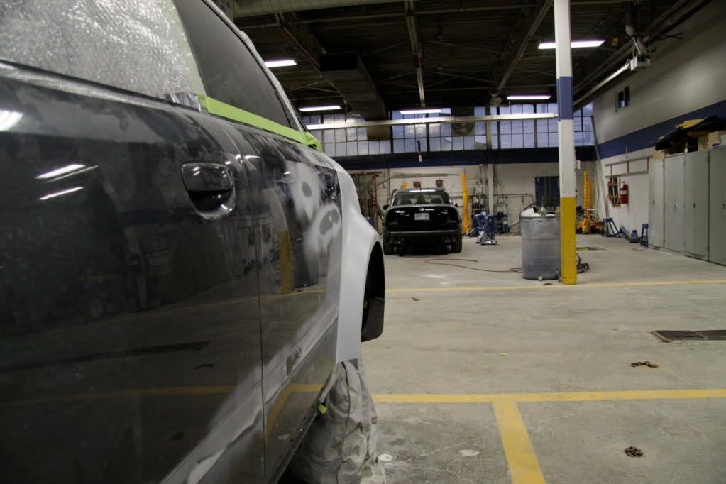

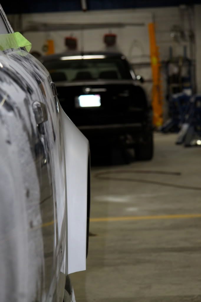

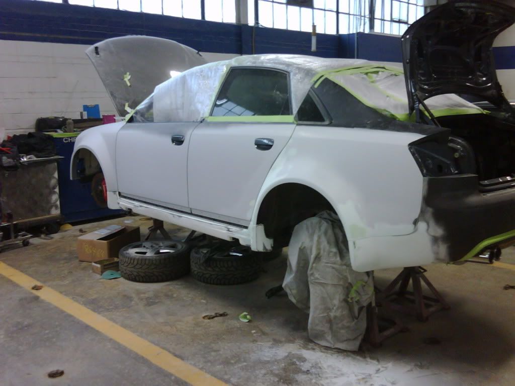

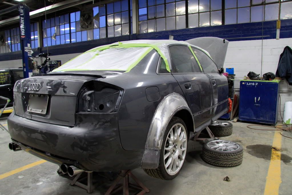

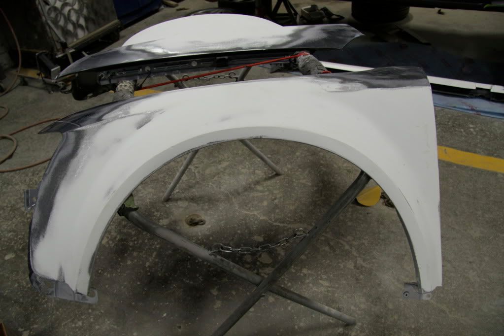

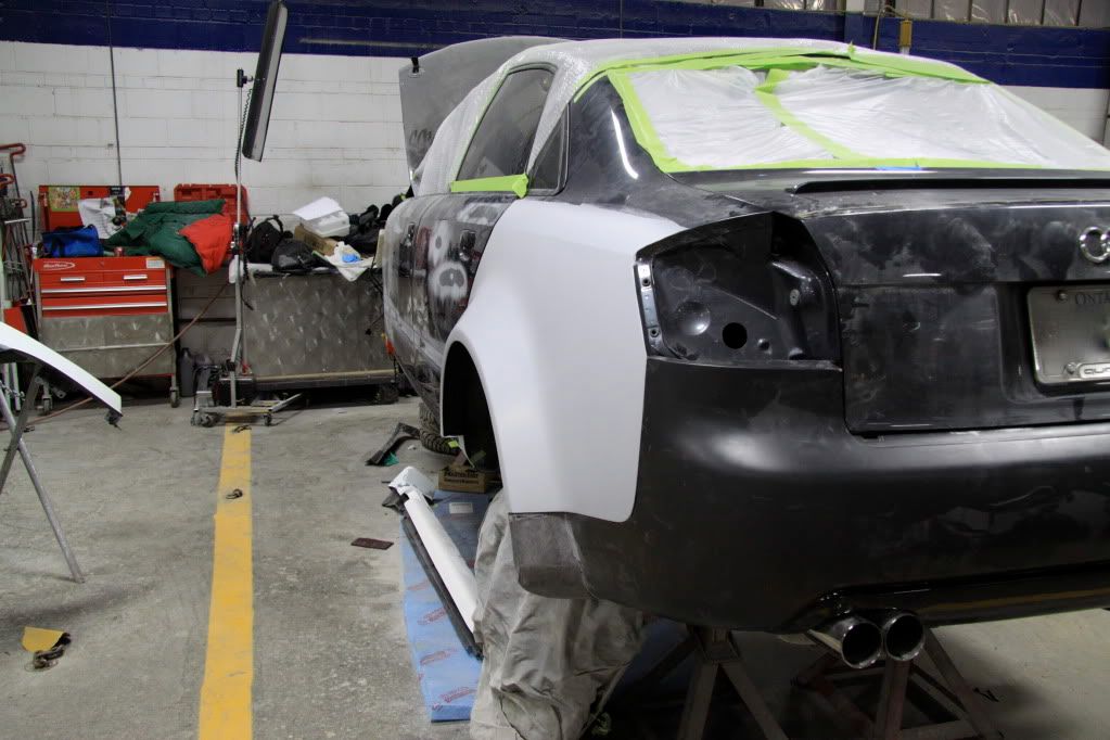

    Decided to start a new thread..
    The car is currently getting prepped and ready for paint.
    After all the prep work is done and before it goes to paint, the car will be towed to the engine shop to put everything back in the engine bay.
    Keep posted for frequent updates and pictures.
    Cheers
    here is some of the previous/related threads.
    http://www.audizine.com/forum/showth...-little-update
    http://www.audizine.com/forum/showth...Finally-Teaser
    http://www.audizine.com/forum/showth...-work-mhmmmmmm

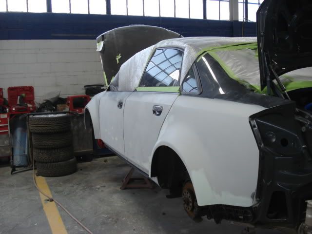

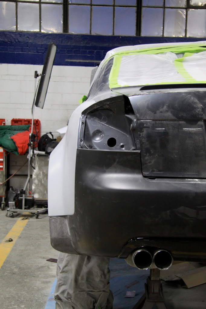

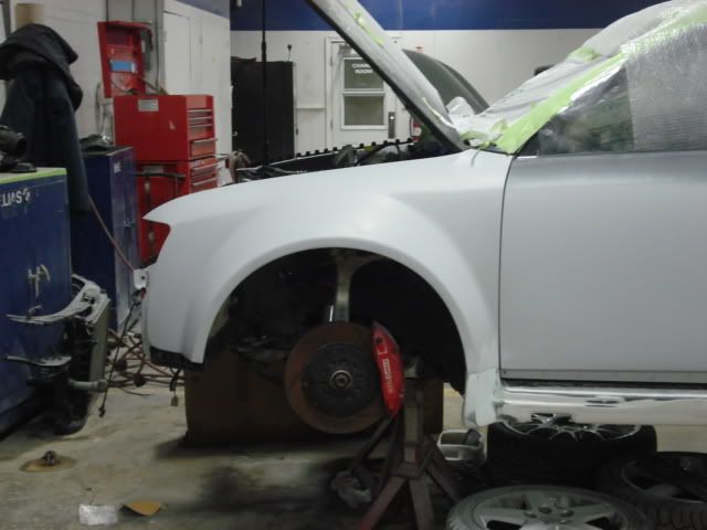

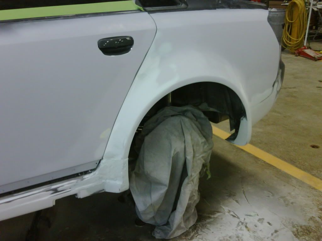

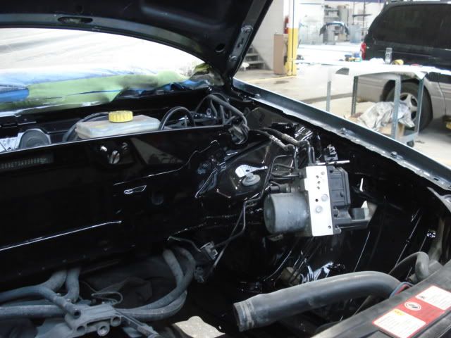

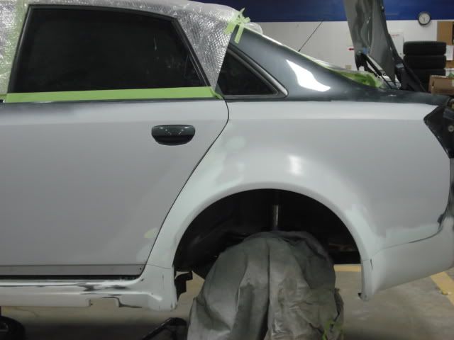

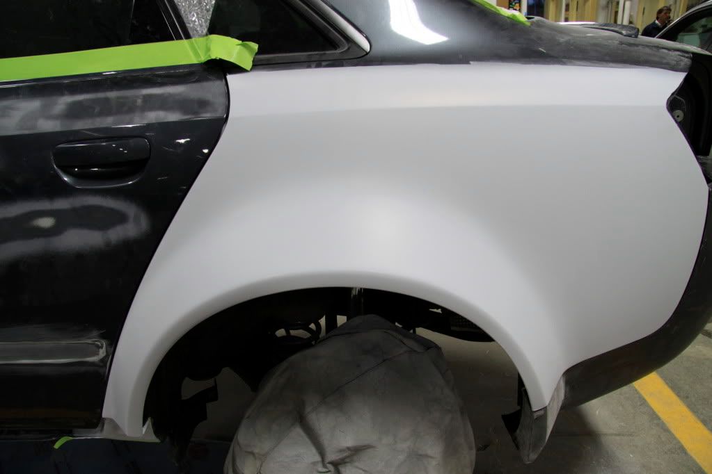

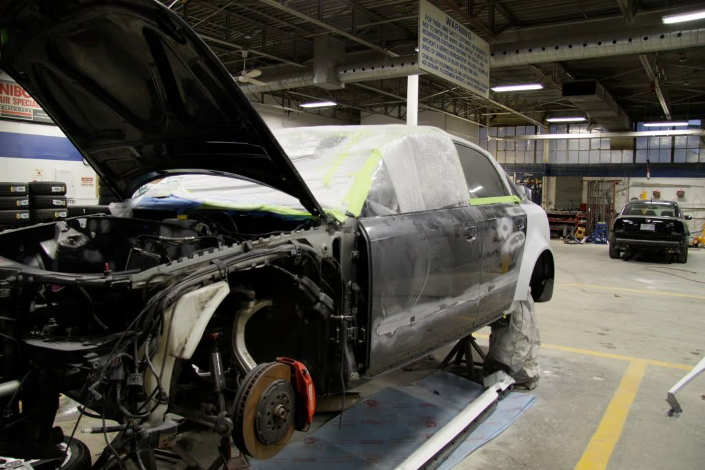

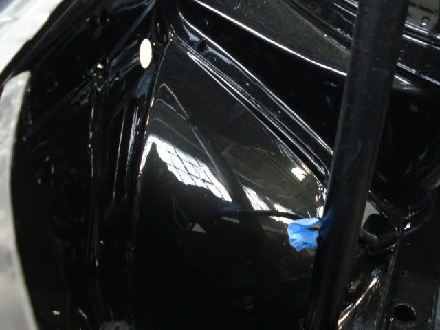

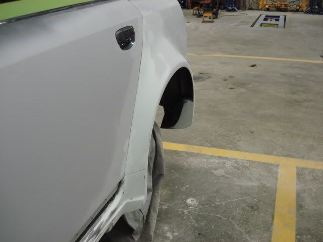

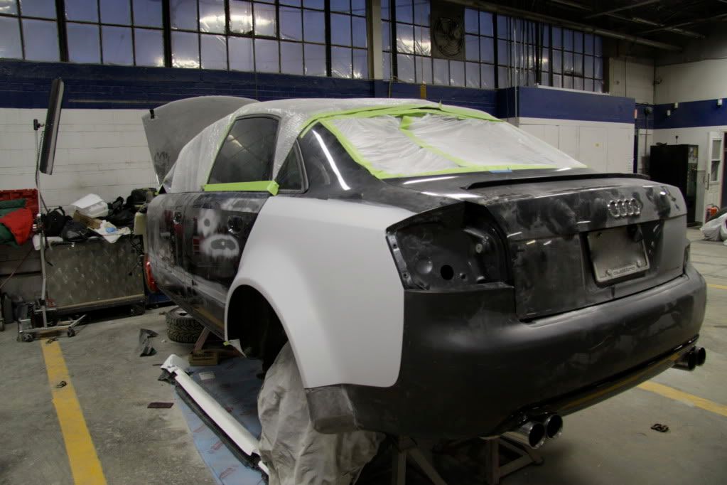

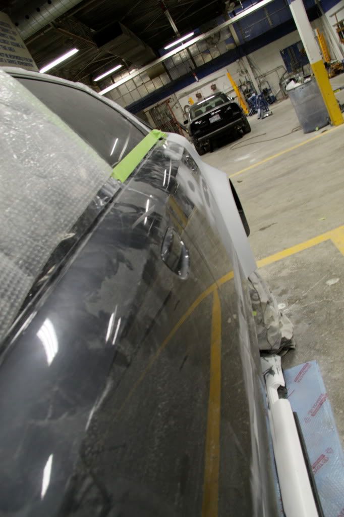

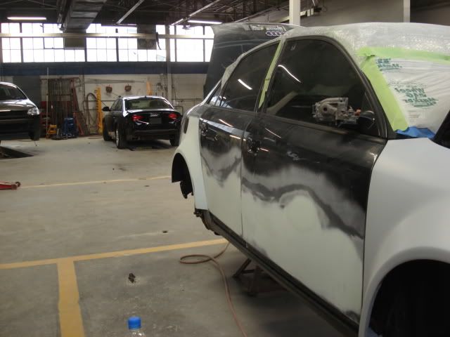

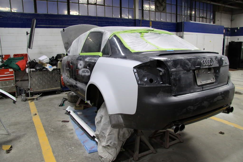

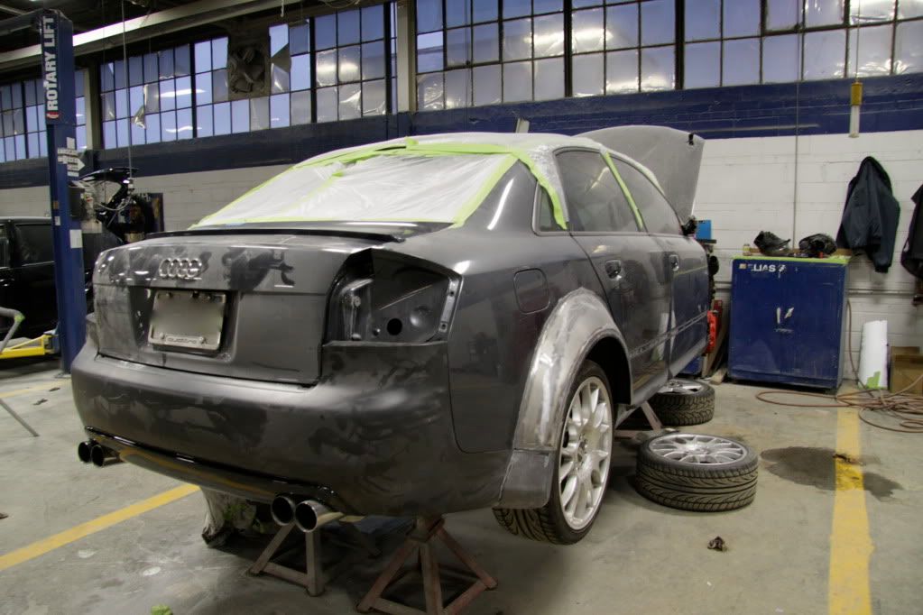

    And some pictures from this afternoon... enjoy

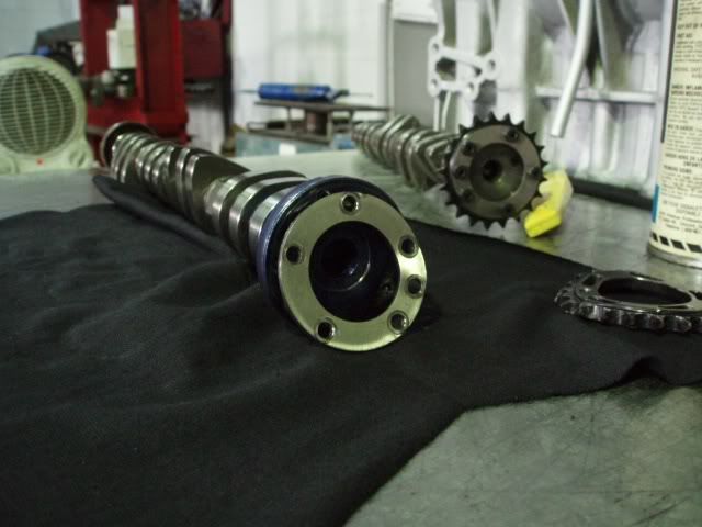

    loool what should i doo! they make bomb power. and the guys over at cat cams are going to replace some of my parts cost, for all the bent valves it caused....
    My builder told me that he is going to make a dowel pin to help the cam gear from slipping.
    What are my options.
    i dont want to cough up more $$$ on cams when i didnt even have them in my engine for longer than 2 months

    AHHHH thats more money to waste... fuk. i have been in contact with Luther (i not sure how to spell his name) over at cat cams. He was not being as much of a asshole as the first guy i was speaking to months ago wen the issue occurred.

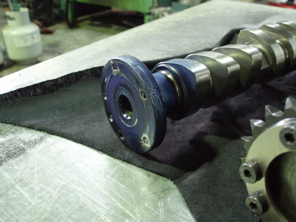

    They asked me to take pictures and what not of the cams. and use a blue dye to see how well the cam gear actually contacts/sits on the back...... and the results... lol all i can say is wow. that's def not en off contact/pressure now i can see why they blew up.
    fukking stressful.

    Here are 2 pics... the contact points are where ever there is no blue dye. (we sprayed the back of the cam with the blue dye, and we just pressed and turned the adjustable cam gear by hand.

    I did not know Cat was doing something for you, Coran. Push them for this is a major design flaw that they should publicly acknowledge. Everyone else I know that has blew up those cams has gotten zero help. In the end it is up to you to take the risk of putting them back in the car.
    Quote Originally Posted by coran nariman View Post
    That is a major design flaw.
    Personally, I would not take that risk even if your mechanic found a way to 'fix' the cams. They shouldn't need a 'fix' if they were designed properly.

    A few pics
    cheers
