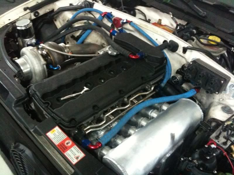

    Quote Originally Posted by NYCVR6 View Post
    Surge tank with fuel pump mounted
    Most everything is done. Just need to finish back half of exhaust and tie up loose ends.
    +1 Rep. Thanks for taking this on and helping the rest of us!
