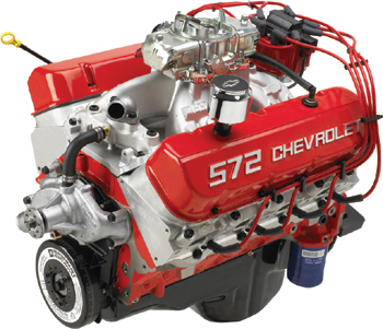

    From that engine bay picture, bro
    after all the shaving you did to make that Vr6 go in, I even thin this would fit
