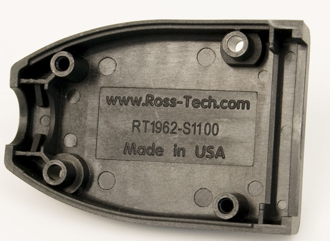

    Man...those plastic housings for your cables do NOT need your name and part number on them. Order those things for PENNIES & throw a sticker on them instead.
